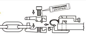

Manufactures assembly instructions
Manufactures recommendation for side load

I should have clarified the type of swivel I used in the past in the previous post. This is it. http://www.defender.com/product3.jsp?pa ... id=2307372 I attached the jawed end to the chain & the round end to the anchor with a clevis in between, though I wouldn't hesitate to use either the swivel you showed or the one DD uses with a CD 22 or 23 Venture. Like DD says the weight & surface area is so small on these boats that it just isn't a concern to me. Of course I wouldn't use or recommend either a cheap china swivel.
