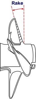

There are many factors which contribute to RPM at WOT including proper setting of the outboard below the bottom of the boat (amazing how many are off), the # of blades, the cup of the prop, and to some degree the rake of the prop.
Rake:
