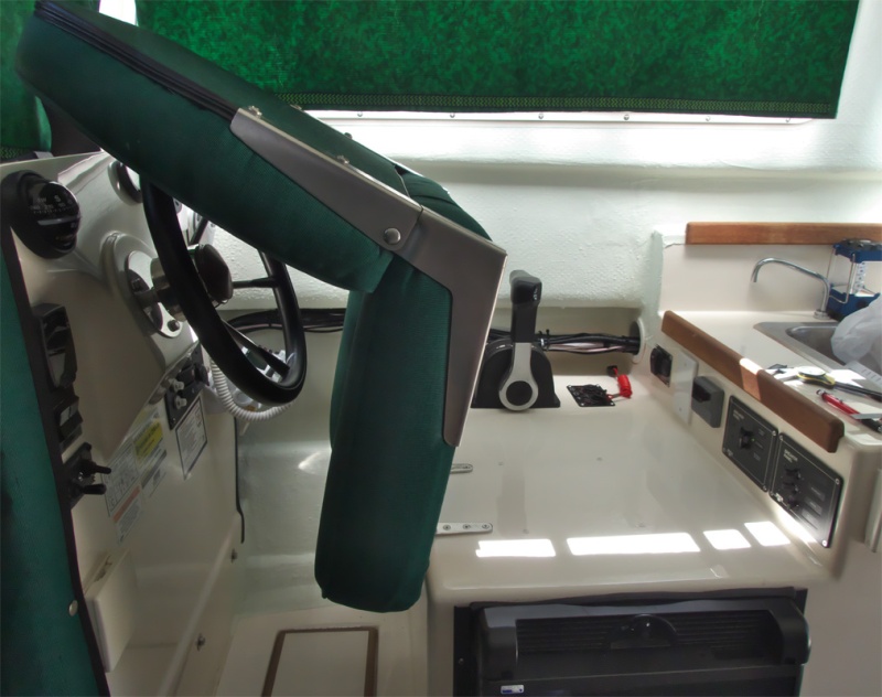

Here are a few ideas we have come up with over the years. We mined under the Vberth as many others have done which is a significant storage addition. In this area we keep a spare anchor and rode, spare props, tools and some food storage. I built two drawers under the helm seat. The shallow top drawer holds our logbook, registration, etc. the large lower drawer has a partition that holds the minimal clothing we cruise with (wife’s side is larger 🤔). I also added drawers under the alcohol stove that holds silverware, utensils, dinnerware, etc. There is some storage under the lower drawer and a large removable shelf in the forward cabinet. The whole unit under the sink and stove is readily removable to access the bilge, wiring, etc. Under the aft dinette seat the 20 gal water tank was removed and replaced with a 9 gal. tank. On extended trips we carry two 5 gal water containers in the cockpit. This freed up room for a large drawer which holds all of our nesting cookware. All of the drawers are on full length, soft close slides with push button latches. The Wallas 1300 sits outboard of forward dinette seat with the fuel tank and other items under the seat. During and after each extended cruise we have made a list of improvements we think up. Good luck and enjoy customizing your boat. Ken
Great pictures! You have really opened up storage in such subtle ways. Thank you so much for taking the time to reply.
