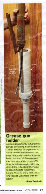

I just put up with the leaking. But to keep things cleaner in the garage, I saw a neat grease gun holder made out of PVC and made several for my self. They work well. I'll see if I can find the design, and upload it soon. Colby
..... Found it.
Thanks everyone... I think I'm going to go with one of the Lincoln models that Steve mentioned, and make one of the PVC holsters that Colby shared.

The PVC tube is slick...But I still prefer a plastic box, since you cannot get the full top and lever into the tub. I suppose one could go with a 4" tube to allow the entire gun to be isolated...
