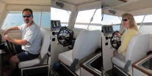

Read your blog post yesterday and as always, it is interesting and informative. Curiosity compels me to ask what seat you installed. Getting the right helm seat is always an issue. Our boat has Garelick seats and while they look like they should be comfortable, the foam is not dense enough and they are not!
Happy T'Giving in the Tropical Tip.
Jim M.
Hi Jim,
Here's a look at the seat...
We got it at Bass Pro Shop (new one just opened in our area); the model is Tourney Special, Big Man Boat Seat. It didn't get great reviews on-line, but I spent a lot of time in the store, trying out different seats... even took Wild Blue's original seat in with us to compare size and foam comfort. This seat is firm; I've only sat on it a couple hours at a time, but so far it's comfortable. The higher back is great. I mounted the seat about an inch and a half forward compared to the original seat - fits better for me. The seat bottom is very close in size to the original. Not sure if the seat in the 25 is bigger than the one in the 22
And a bonus: there were two pieces of teak used as spacers under the original seat. I'm planning on a shelf under the table, and that teak is just what I need for the trim. I cut some HDPE from an old cutting board to use as spacers under the new seat.
