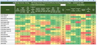

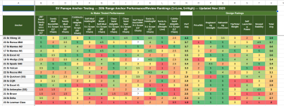

As was recommended here, I checked out the anchor test videos by YouTuber Steve Goodwin. His channel, named after his boat, is SV Panope:
I was interested in the 20lb anchor tests (doubtful I'd get one that big, but it was closer to my world than the 45lb tests), and wanted to paste-in his summary table updated most recently in 2023.
After that, more recently, was a test of the Viking, Odin, and Ultra anchors, in which he says what many knew, that the Ultra (well over $1000) was the best non-rollbar anchor (note, the Vulcan by Rocna in the chart above is also a non-rollbar) and that the Odin, while good at some things, had issue with sandy mud and was not as good. He did not update/post this table in that video.
He also mentioned the new "performance" line by Mantus, which has scalloping on the shank for weight savings (getting a higher percent into the tip), and was cautiously optimistic that those versions, since gone to production, would have been notable improvements, but he has not yet tested them. He said if he gets some, those will be his next anchor tests.
In his second chart, which is organized by overall descending performance across all seven of his sea beds, he said a good measure is look at the 20 holding factor line and find anchors that are at or above that line in six of the seabeds. He said to rule out the red bars, the cobblestone-- no anchor does well there-- and you have a good overall winner. He said they were all rollbar type anchors: Viking, Mantus M1, Rocna MK2, and Wedge. He did say note the MK2 ("Mark 2") just barely gets past that line. He said Viking, Mantus, and now Wedge, were your best all around performers.
BUT, my strong recommendation to anyone like me looking at these videos and reading reviews etc., is to verify with charts/books what the most common anchor bed conditions you will encounter where you plan to boat. If you're in the Chesapeake, that's different than Florida, which is different than Maine, than Alaska, etc.. Also, verify the anchors against conditions you might encounter, such as big tidal reversals or high current tidal rivers etc, exposed areas with changing winds, etc.-- you want to stay put and sleep well.
It's like Consumer Reports ratings-- the highest performing 1-2-3 product might be the worst one for you. Eg, a Mantus M2 above was the #3 all arounder, affordable etc., but then is a 1 out of 5 for 180 degree reset in soft mud. If that's where you live, that would be perhaps the worst anchor for you.
Lastly, because I don't want to start a full thread with it, this guy Steve (Panope) put up a video adding a small mizzen sail/mast to his sailboat that was hunting/sailing/yawing at anchor, and has a time lapse video of it with/without (before/after) and the results were fantastic! I wonder if there is room for a mini one mounted to the outboard/transom that would have the same effect.
The two sources for the anchor chart and other comments:

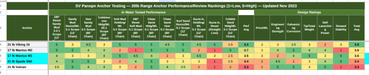

I started my narrowing down by copying Steve Goodwin's table above into Claude (AI) and having it convert it into a color-coded spreadsheet (1=red --> green = 5). I focused on what was important to me personally where and how I'd be using it, and got my final 3 to then price-out. But out of a hunch, I went back and checked a larger size of the anchors on his channel and was surprised to see some differences between weight classes of the same anchor. That gave me pause, because what if the smaller 13lb sizes are not as effective as the larger ones, or vice versa etc-- and why? Maybe larger rollbars plowed like snow, and a smaller one may not have the necessary scale, etc..
So, here are the two anchor charts, color coded:
Then I combined them into a single chart, looking for patterns. There were some categories in one chart not on the other, so I had to temporarily removed those, map it a bit, and re-do the averages to reflect only those categories appearing in both charts. Here is the combined chart.
It shows that, for instance, the Bruce is a bottom performer in both sizes against its peers (for THAT person's tests). And that Viking was a top for both sizes. Shows a good swing from the older generations to new, also. And generally how the size of the anchor affects its placement. I'll poke around some more, as I enjoy this sort of thing.
Reminder, this isn't comparing a 50lb to a 20lb, it's just looking at general placements of same-class performance, to see which ones travel together with size and which ones actually differ and how.
EDIT:
Like this. I started coloring named pairs, and seeing which names were at the top for both sizes. And then Excel was really spread out. Not knowing enough, I'd just as well delete that one as saying "can't rely on tests". The Quickset was close for both sizes, showing it scaled well, but was pretty "middle of the pack". Viking, Mantus M2, and Vulcan scaled well.

Then it came down to size and shape-- something to help tie break. They're both rated for our boat size and anticipated storm loads. Physically, the Mantus M1 Performance size:
From bottom of tip to top of shank on the Spade, the "D" is 315mm = 12.4 inches.
From bottom of tip to top of rollbar on the Mantus M1-P, the "B+G" is 16.2 inches.
Width of the scoop on the Spade, "C", is 11.6 inches.
Width of the scoop on the Mantus, "L", is 16.5 inches.
Distance from furthest side of chain attachment hole to hull-nearest pointy tip of Spade, "F", is 13.2".
Distance from furthest side of chain attachment hole to hull-nearest pointy tip of Mantus M1 -P, "H - F", is 14.7".
On this one, I believe the shape of the Spade will actually keep the tip further away from the hull than the Mantus M1 -P.
I also liked that the Spade had a solid shank and parts, whereas the Mantus (and almost all rollbars except the MKII) are hollow, meaning you need to clean out the muck carefully or you get cement and it throws off the balance and can lead to breakdown of the galvanization and lead to hidden corrosion.
So, with the better aesthetics to me, the smaller visual size, the heavy tip, the superior setting and veer in the sandy mud (most of where I'll be), the no roll bar for seaweed or impeding "set it and wait" deployment (better for getting down into soft mud), and presumably not needing nearly as much alterations (if any) to my bow roller, the good anecdotal performance for my cruising grounds, and without the typical "scoop [up the muck]" shape, and the fact that it's a bit different but also proven, I decided to pay the $190 price premium. The lower the prices, the more wonky the percentages seem ("oh that's a 55% premium!"-- yes, but $5 vs $10 is 100%, and in this case I think I'd even gladly pay $190 divided over 10 years = $19 a year to not look at a giant hoop again on the front of my pretty little boat. If it also means I get less muck, and have better performance, well then it's a clear good choice to this Brat.

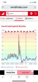

Thanks. I suppose it's worth adding that I'm not doing it in doubt or in fear, but in trying to learn for myself about anchoring, where things go wrong, and where people's strong opinions are made and/or changed, and then share it for anyone else curious enough to read words these days. I saw so many "what anchor and rope should I buy" posts here and across several forums, FB, etc. This seemed a topic worthy of "go figure it out", rather than something else I'll need and just want an answer, like "where can I get the window seals please just tell me", not because I value it more, but because it's actual people and property at risk. Sure, the 22 is a nearly flat bottom, pointy, corky boat, that can tuck into a puddle, so even with high wind, I don't see hardly any danger for a C-Dory 22 at anchor, but I wanted to learn the thought process that will let me scale it faster than my time available for trial and error-- and share it.
I also was simply shocked last year by a microburst which turned our river from sunny placid to "holy sh*t!" wind and fetch in minutes, and wanted to know for sure the limits of my gear for our trips to Maine etc. If you were rock climbing or scuba diving, neither things I do, you'd want to actually know rather than just say "that should be good enough" or "I went one size larger, that should be plenty" or "most people seem to be using this". Here, I went through my photos and found the wind chart for that burst (measured about a mile away from my house on a buoy in the adjacent Providence River). It really came out of nowhere!
