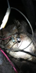

I replaced the fuel sending unit from my port tank. The old unit was sticking, sometimes near full, sometimes near empty.
I cut the wires from the old unit and hooked up the new one to test it before removing the old unit. It read perfectly with the ring in the full position and changed as I moved the ring. Replacing the old unit wasn't too difficult, but the starboard unit is another story. I can't find it without removing the toilet or cutting the deck. It's still working, so I'm going to leave it alone for now.
