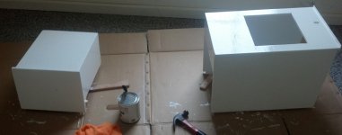

Two coats of paint. Tomorrow a light sanding, a third coat of paint and then to the boat.
The cabinet is finished. Now all I have to do is drop in the stove, put it in the boat and hook up the electrical, fuel, and exhaust.

I know, the brass latch and aluminum handle clash. My wife will be sure to inform me of that as soon as she gets back from visiting my son in Hawaii and sees it. But I'll tell her what I usually do, I'm cheap and they were cheap too. All together I spent about $75 on plywood (I had some, only bought a couple of 2'x2' pieces), screws, aluminum angle, drawer slides, and paint.
