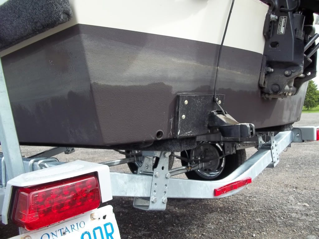

Looks to me like you need a set of bow boards . Two more bunks that are inside the main ones and go forward to keep the boat centered and off the frame of the trailer .May need another cross member to support the front brackets for those bunks . It also appears that you have drum brakes on only one axle.In many states here [good ol' USA]you are required to have brakes on all axles with a gross weight of over 3k . I would specify discs . Give them a chance to make it right . I know its frustrating but ask them to call the west coast EZ Loader factory and get the correct specs for the C Dory 22 . They have made a zillion of them.

Second the disc brakes. Florida and at least 10 other states require brakes on all axels. I believe Canada also does. What brakes did you order? Kodiak is better than Tie Down for brakes.
After our discussions--not sure that torsion axels are that much better than spring...possible not as good weight distribution, detiorration of the rubber insert for the "Torsion".
I agree about the torsion/springs support,the only reason that i ordered them is that some-one posted that torsion axiles will lower the boat on the trailer.I can live with the springs and the length but that winch has to go,what if i wanted to change to another winch or even put an electric winch on the trailer ..the way the winch post is configured it would be impossible, i would have to replace it with a traditional winch/post/setup....I not sure if i have disc or drum brakes on the trailer,i don't have the invoice yet, the only option the dealer gave me was electric or surge brakes.Can you tell which type i have from this pictures.

You have drum brakes--surge-=not electric--and you don't want pad type electric (like in house trailer). Bunk boards forward will give far better support than a single roller. There is a lot of boat not supported forward in your trailer from the photos--and the boat is not all of the way forward there.
