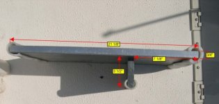

Here are the dimensions for the generator platform on Lucky Day
[/img]http://www.c-brats.com/modules.php?set_albumName=Lucky-Day&id=Dimensions_from_side&op=modload&name=gallery&file=index&include=view_photo.php[/img]
The platform is 12 1/4" wide. If viewed from above, the starboard side has an angle cut at the forward end to accommodate the angled seat in the stern.
The material used to cover the chain and to pad the ends appears to be a soft plastic tubing with a wall thickness of about 1/8". The edges of the platform are covered with a sheet metal or aluminum cap.
Ooops -- My attempt to load the photo directly into the post didn't work. (There must be some HTML code missing.) The photo with dimensions is in the album.
