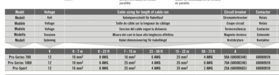

It might slightly depend on the run. On my 22 I just barely made it into the #6 category, and #8 would have been too small for sure. Reason I say that is that for the 700 horizontal their chart shows you can have up to a 50' round trip run for #6 cable (#8 only gives you a 23' round trip run). I think I figured it out (IIRC) that their max would be close to 10% voltage drop. Also IIRC, I'm at around 45' round trip on my 22, from the windlass to the contactor and then on to the the battery in the lazarette at starboard stern. But the 700 takes a 50 amp fuse to the 550's 25 amp fuse. Also, maybe your batteries are further forward on the 25. Otherwise you might want to double check. Although now that I say that, there is something odd in the chart....
They show the "Pro Sport" (is that the 550?) and as expected, it must draw slightly less as the breaker is smaller (25A to the 700's 50A and 1000's 70A), but yet they show the Pro Sport as needing larger cable than the 700...? Something looks wrong there to me. I'll post the chart here in a moment.
I do know that many folks with 22's who have the 700 horizontal have wired with #6 cable, and when I calculated it on my own with a voltage drop calculator, I also came up with #6 for the 700 on my 22 with the ~45' run.
But maybe the 25 is set up so you would have a shorter run, or maybe if the chart is wrong, #8 would work for the 550. It would make sense given the 25 amp breaker vs. the 50 amp one.
Okay, here is the chart from the manual for the 700/1000/Pro Sport (is that the 550? It does have the gipsy on port side). There seems to be something odd going on with the wire gauge sizing for the 550, unless I'm just reading it wrong. It doesn't seem to track with the apparent lower draw suggested by the much smaller fuse (?). Or am I just suffering heat stroke?

Well the compromises are piling up. I forgot that the wire run measurement counted both ways and doubled 23 to 46 which means all new wiring in order to accommodate either of the 700 series. That's another $150 and a project. For now I'm inclined to want a horizontal model so for now I'm comparing costs , reliability and project size between the 700 horizontal and the 550. Project wise it's a no brainer, the 550 is a drop in replacement. I have to do some more homework on it to see if any CBrats have experience with them and talk to Lewmar again. They were very nice to deal with and honest about their product's good and bad points. The present model Horizon 400 is 10 yrs old and still runs fine and it is the real low end of their product line. It does the job well so maybe if I can convince myself that the 550 is at least as good it might be ok.

One thing that drives me nuts with calculating DC wiring is the charts or guides that are "fuzzy" on whether or not they have already taken the "up and back" into account. I mean, I know you have to count both ways, but some charts/calculators "do that for you." In fact, I think that's why I ended up running the Lewmar guide specs through a voltage drop calculator - their wording wasn't totally clear to me on whether or not they were doubling your one way distance for you or expecting you to use the round trip number. They said it like this:
The cable table gives recommended cable sizes based on total length of cable required, from the battery, following the route of the cables.
So were they "halving it for you" or not? I couldn't tell for sure! It was almost worded to sound like one-way, to me. As it turned out they were not -- I ran the specs through a voltage drop calculator for the 10% maximum they specify, and it is round trip they show on the chart; but it could have been a bit more clear if they had said "from the battery and back" or "round trip" or something, I think. Not that I didn't already know it really IS round trip that matters, but as I said some calculators/charts already take that into account "for" you.
