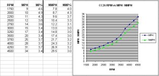

For those of you who are considering a Venture 26 here are some fuel consumption figures that may help in your decision. These numbers were taken last week on a cruise in the San Jauns that my wife and I went on. The hull is a CC26 with a 200HP Honda. The data numbers are taken directly from Honda electronic gauges. No consideration was given to GPS speed do to currents that may be present (although they were very close). I took readings several times and decided to go with fixed RPM for a standard because there could be a couple hundred RPM difference for each MPH. Using RPM the readings were fairly consistent. There was a light chop and the motor was trimmed to three with trim tabs up.
RPM / MPH / MPG / GPH
1750 - 9 - 4.6 - 1.9
2000 - 10 - 4.9 - 2.0
2250 - 11 - 4.3 - 2.5
2500 - 12 - 3.8 - 3.1
2750 - 14 - 3.6 - 3.8
3000 - 15 - 3.4 - 4.5
3250 - 17 - 3.4 - 5.1
3500 - 20 - 3.4 - 5.8
3750 - 25 - 3.7 - 6.6
4000 - 28 - 3.7 - 7.5
4250 - 31 - 3.7 - 8.2
4500 - 34 - 3.4 - 9.2

Hi Forrest, thanks for the posting your data, impressive indeed! Can you provide any more info on your boat's loading at the time (fuel on board, water, # people, raft, raft motor, etc)? I took the liberty of plotting your speed data, hope you don't mind.
(Edited chart using 0.868976 rather than incorrect 0.85 to convert statute to nautical miles)

Well I made an error... :oops: ... I allow myself 1 a year, but the year's young, oh well. Larry H correctly pointed out in a PM that my conversion factor for statute to nautical miles was slightly off, I used 0.85, it should have been 0.868976 to be exact. It increased the nmph's by about 1. I corrected my original post and chart. Thank you Larry!
I was asked (Starcrafttom) to include my CD25's RPM/Speed data on the same chart. I decided not to include it because mine is quite underpropped and I didn't want to purport that kind of data for comparison until I reprop (someday...).
Then I added the MPG and NMPG data to the CC26 chart, here it is.
