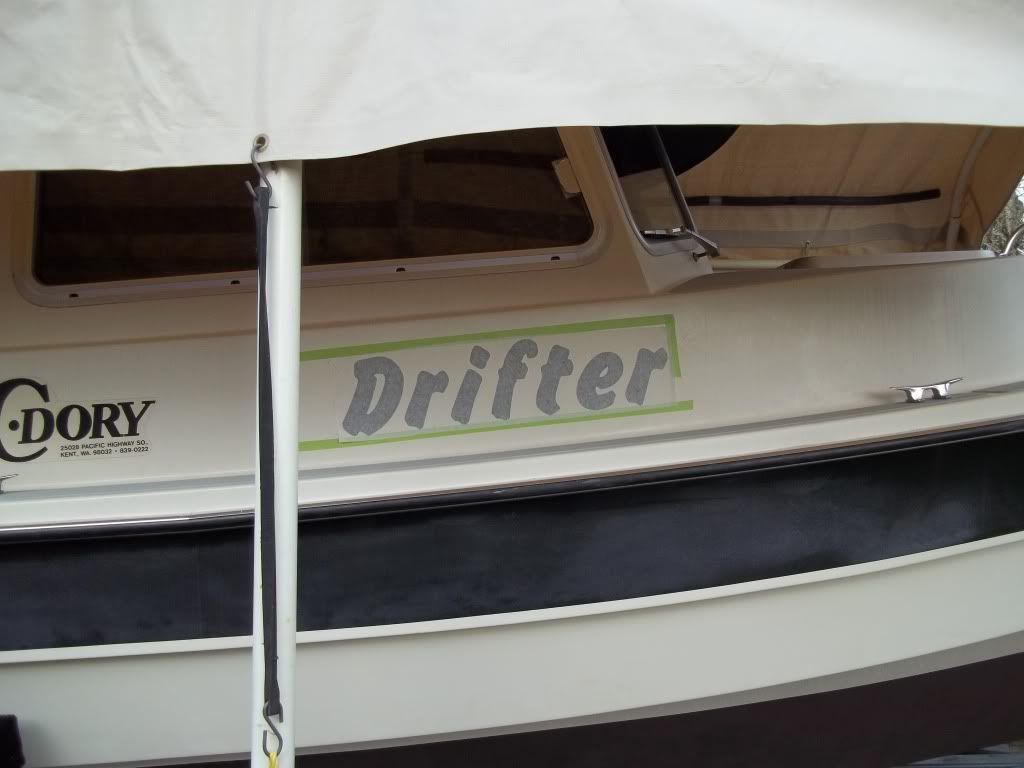

Put my new boat name on today but the letters wouldn't stick.Bummer.I called iboats.com where i bought them and they gave me the number of the manufacturer,"Vyln By Jenn". I called them and they said that they never heard of them not sticking before but agreed to cut me some new letters and ship them to me.I had followed all the steps as per/instructions so i cann't really figure out what went wrong.Here is a picture of the letters taped off on my boat, i gave them 1/2 an hour before i peeled off the backing paper but the letters wouldn't stick to the hull.Anyone ever had this happen to them. Is where i placed the name in a good location or should the name be more towards the bow. Tug

Wow. I've had the inverse problem, sticking too soon.
Actually, if there's adhesive on the back of the letters AND the fibreglass is clean, they should stick. Did you polish the boat there recently?
So, since you've ruined the present letters, try to see if there's any glue on the back of them. Try sticking them to a piece of metal and see if they'll stick.
If they pass that test, clean the side of the boat with lacquer thinner. That should take off any polish. And try again, before you get the new letters.
Good luck, Boris
From an old sign painter. Remove ALL wax or other polish. Use a squeegee to completely remove all the air from under the vinyl and set the vinyl to the surface. Carefully remove the transfer tape by gently pulling it back parallel to the surface, not up at right angles. Then press each letter by hand paying attention to the edges...work from the center out. Removing the wax or polish is critical. Large vinyls can be installed by spraying water with a drop or so of dish detergent on surface which will let you slide it in place before squeegee. Good Luck.
I did clean the boat yesterday but used just soap and water, there may of been some wax from last year.When i get the new letters i will clean that area with soap and water first than with cleaning alcohol or lacquer thinner if i have any in the shed. The letters were a little sticky but not enough to stick to the hull and release from the paper. They may of picked up some wax from the hull.Thanks for the tips.Tug

Nice of your supplier to re-cut the lettering for you. Placement looks fine to me.

Put my new Boat name on today,cleaned it with alcohol before applying the letters.The letters still had a hard time sticking,kept peeling off with the paper but finally got it done anyway.I posted a few pictures,hope they look straight..Tug
The two pictures in your photos look like you did a fine job!

They looked good from here:
I like the rounded corner fonts. Less likely to peel up at a corner.
