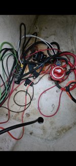

Does it seem doable for someone with limited electrical knowledge to relocate the electronics from in the starboard rear hatch into the cabin under the sink? I would like to install the battery selector under the counter top. Thanks!

This is possible, but there are a few decisions to make ahead of the project.
1. Are you planning on moving the batteries forward into the cabin? At a minimum they should be AGM type if they are in the cabin.
2. You want to have the least amount of cable distance between the battery, battery switch and outboard connection point.
3. 12 volt DC voltage drop is a real thing, so it must be part of the project plan.
4. Plan on using #1 tinned copper (or bigger) from the battery selector switch to the junction point powering the outboard. Take measurements and have the cables pre made with the right crimp lugs installed.
5. All existing wiring needs to be traced and identified as to what it is powering or grounded too.
6. The condition of the existing wiring is important, corrosion or discoloration of copper exposed to saltwater may require new wiring.
7. In 12 volt marine wiring, all grounds should go to a single point connected to the battery negative terminal.
If you are going to leave the batteries in the back and run the cables to the cabin disconnect, they will have to be really big because you are doubling the distance of the wire run.
On my boat, the AGM batteries are forward and near the battery disconnect. I ran #1 tinned copper 8’ or (16’ round trip) to a connection post with the 90 horse Honda outboard. The motor spins and starts effortlessly. That means the voltage drop is negligible.
Hope this helps you with an assessment on taking this project on.
Flashyfish gives you excelent advice. I will add some:
The main battery cable to the accessories should be fused within seven inches of the battery according to ABYC standards. There are exceptions, but your plan does not meet those criteria. The motor start circuit is exempt--however with this long run I would not be comfortable with the #1 cable not being fused. You would need a 500 amp fuse to carry the starting load.
There are ways to remotely turn the batteries off from the cabin involving relays--but it will be more expensive, and complicated. I don't see any reasonabe way to move the main battery switch except as above.
However you can and should certainly move that terminal block and all of its associated spaghetti up forward. There appears to already be a 30 amp to 60 amp breaker near that switch. It can be cleaned up a lot and that breaker used on the wire connecting to the consol.
Take a #10 tinned positive and negative wires from that breaker (unless you have a windlass in which case I would use # 6 wire) running from that breaker to a common fuse block behind the console and do your distribution there. That is the way the boats are factory rigged.
What is the purpose of moving the switch to inside the cabin? You can put it either in a concealed place if that is your plan, or on the outside of the side wall of the splash well, if you want to make it more convient.
It's a good opportunity to do some research and learn how your boat electronics are powered.
Use a DC wire gauge calculator, and remember the wire length is the total pos+neg length. You can account for the voltage drop by calculating the correct wire gauge without guessing or spending too much on excessively oversized wire. http://circuitwizard.bluesea.com
