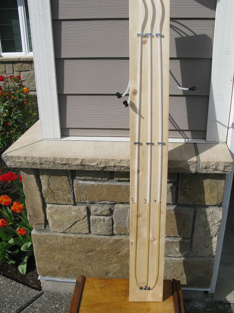

For me, in buying a used Honda BF50 2003 carbed unit, was, initially, the price I was able to pick it up for. However, after a season of using this reliable engine I decided to see if I could improved the low speed smoothness (idle to 2500RPMs. I built my own manometer and found that the carbs. were out of synch a bit.. My manometer is very sensitive and I think I have that part nailed down now. Secondly I am starting to try a Yamaha product too (LOL) called "Ring Free" and I believe its improving the performance as well, by de-carbonizing the ring grooves and combustion chamber-etc.
