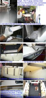

The rope locker is three sides made of 3/8 ply, finished with epoxy and paint. The lower edge is curved to match the deck. The top is also 3/8ths ply with a stiffener rib underneath. The top has no hinges and is held on with a stretch cord and has a rope tether to prevent loss.
With the three sides resting on the nonskid of the deck (no caulk), there is drainage. The sides and front are held onto the cabin trunk front and the deck with SS angles thru bolted with #10 machine screws and nuts.
The locker holds 300ft of 7/16ths nylon and 30 ft of 1/4 chain.
