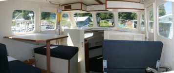

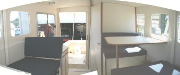

The boat came with zero interior...so, other than the gunnels, side walls, and top.... she is a custom build. The same guy who built the cabinet work in my other boat and works with other C-Brats in the Oak Harbor area did the work. He is great. Still all the AC and DC wiring and plumbing yet to do...but, the main cabin area has been built.
Final price is still up in the air a bit... but she should come in just about what the standard Rosborough sedan hull would...but, she is custom.

To me, a couple of the most positive changes are moving the head out of the v-berth area, and a webasto forced air furnace. This should be a great boat.

Here are a few "quick" photos made during production and layout. Some things are going to be different, but, we were at a point we could make some pics prior to taking the interior apart to cut the floor hatches and do the under floor work needed. Table will be lowered about 2" for a better eating/working height and some drawers installed....

No sir. The panels are all cabinet grade 3/4" ply with a laminate vacuum-bagged onto it, all trimmed in mahogany.
The laminate allows for a surface that can be cleaned easily and is more durable than the Decraguard.
