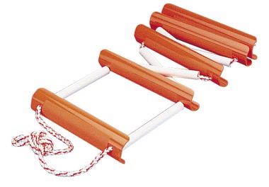

We have a rigid ladder on our swim step and of course prefer that over a flexible model of any kind. We had this one from a previous boat and simply don't have a need for it anymore. They are quite easy to use BUT they require very solid handholds in the right positions and that is what most boats lack limiting the effectiveness of the package generally. But it still beats no ladder which is exactly where some folks find themselves.
Greg
A little tip for those who do not have a boarding/swim ladder. Take a length of thick rope, put a knot in every foot, add a loop at the end for your foot. Attach to the grab rail on the aft of the cabin bulkhead. Leave coiled down on the gunnel where you can reach it from the water. Just might save your life.
