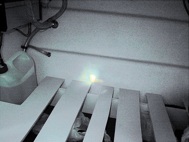

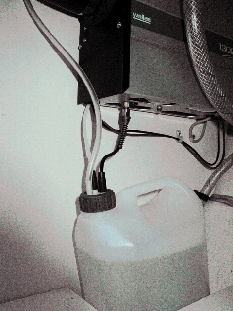

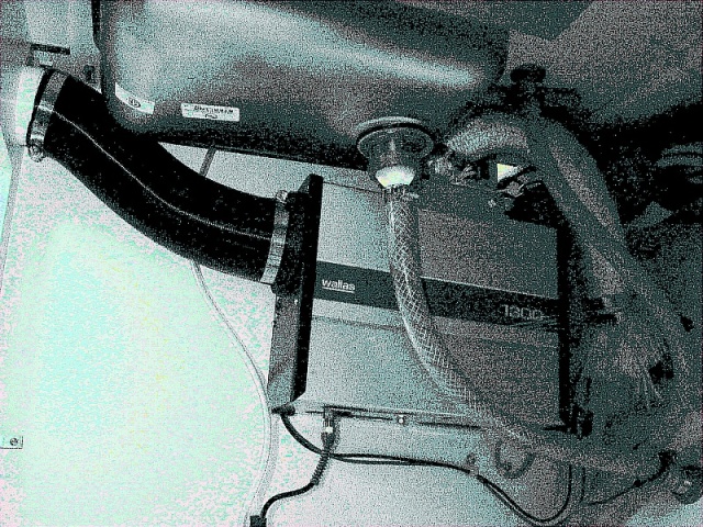

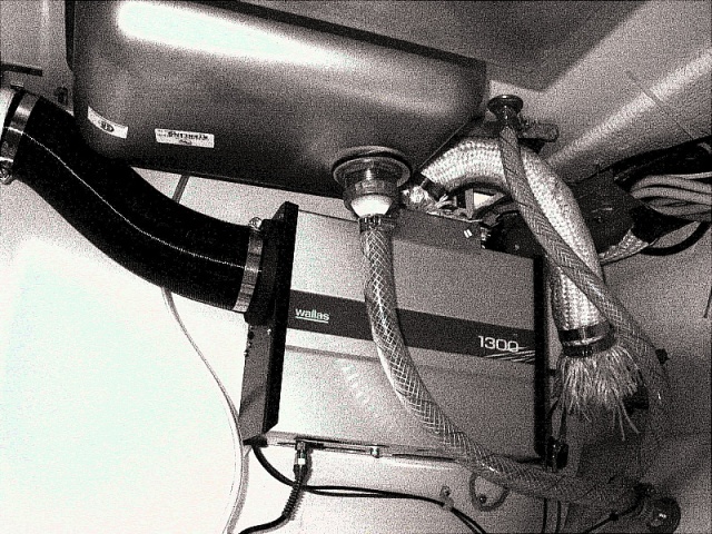

I promised some pictures and some more info. Well here are some bad pictures, however, you can get double your money back if you complain.
This shows Wallas 1300 installed on cabinet wall under sink. See Dora Jean’s album for good photos and write up by Steve.
In my 22 I mounted 1300 inside cabinet behind helm seat. There is a three inch duct with warm air to white plastic register. The two way stainless pipe is covered in the fiberglass insulation sleeve in these pictures. The water hose tubes never touch the stainless pipe although it may look that way. I put in two pieces of galvanized sheet metal on the underside of the cabinet top where the stainless pipe came close to the top and also where it came close to the many wires I have running below the countertop.
The heater is meant to burn kerosene or paraffin according to the manual and according to Scan Marine’s notes in the manual. I have been using Klean Heat kerosene which is a nice clear kerosene in one gallon bottles. Next year I may switch to the regular Klean Heat. There is no odor with the kerosene. It uses very little fuel.

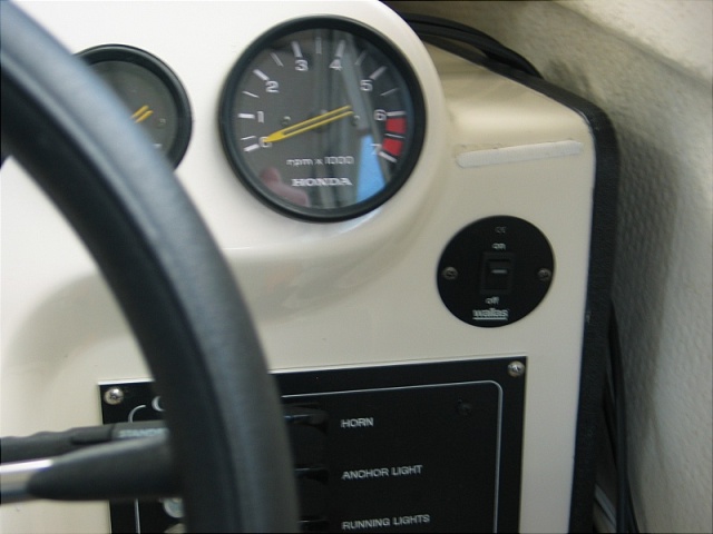

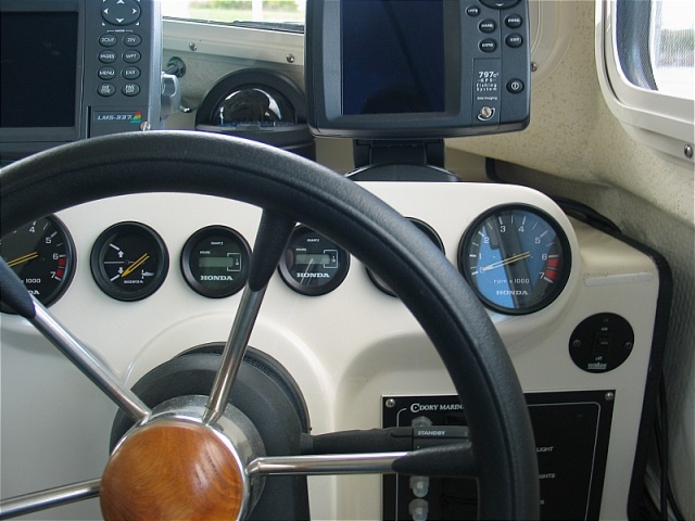

This is a picture of the Wallas on-off switch on my dash.

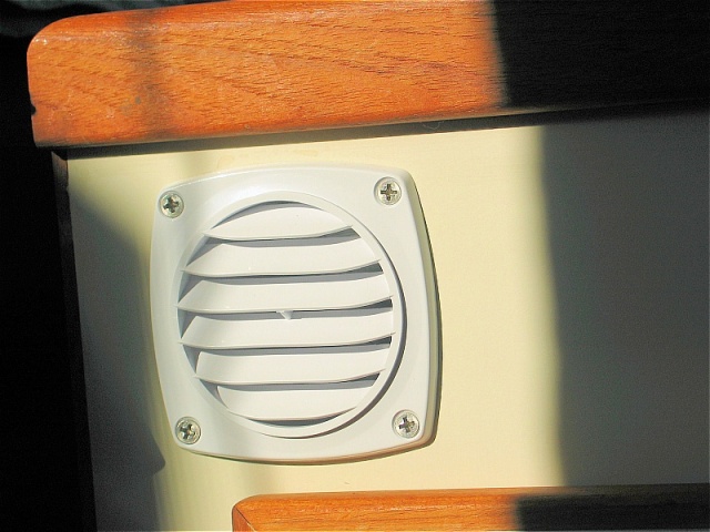

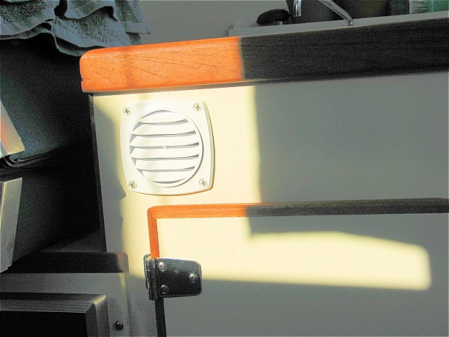

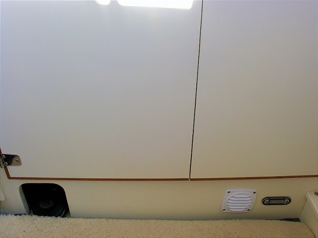

Picture of vent at upper forward end of galley where warm air comes out.
I put a plastic surround around the water pump bellows to encourage cool air to flow through the duct further aft. Some air will also enter the galley behind helm seat where the wiring is. This air is only to supply the room air that is heated. The combustion air comes through the outer tube in the double stainless pipe (direct vent style) and the hot exhaust air flows to the outside through the inner tube of that double pipe.
Next to the “cold air return vent” near the deck is a red led light, one of two I installed.
