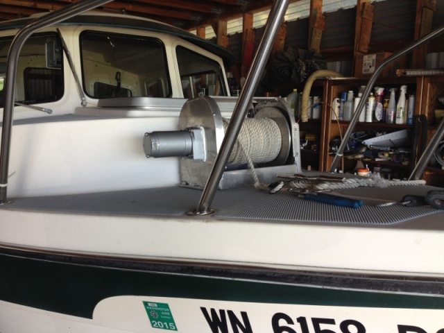

How about level wind vs bunching up of line? No chain on these drums? 6 meter boats= 20'
Clutter of deck--see photo and consider that anchor rode (chain) would bang on deck--solution may be teak or SS tray for chain to lie on when not pulling, or be disconnected, but then you loose a primary function of an easily deployable anchor from the helm--to deploy in an emergency. I have not had to deploy an anchor in an emergency, but I have had to on larger boats, when there was loss of power or steering in a tight situation to keep the boat from crashing into other boats or ashore (on rocks).
Cost = 3 to 4 times of a Lewmar Horizontal axis? That is the most common windlass used on C Dory.
Here is a photo of what I believe is an EZ puller (?); my apology I don't remember the name of the C Dory
