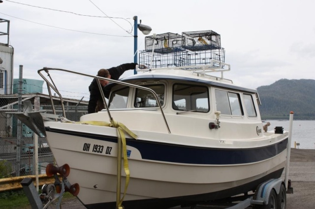

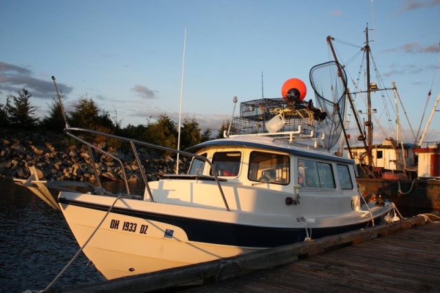

Here are a couple of photos I saved of some sort of traps (crab, prawn? I don't know how to tell the difference) on a roof rack on a 22 whose name I can't remember [Edited to add: Found it - it's the 22 named "Reel Action"].
Added: Hear is a link to Reel Action's album:
http://www.c-brats.com/modules.php?set_albumName=Prince-Rupert-May-2009&op=modload&name=gallery&file=index&include=view_album.php
I saved the rack photos because I hope to need to use this idea some day Very Happy

That aluminum rack looks very similar to mine. It took me about a day of screwing around to decide what to build, about an hour to cut the aluminum, and a whole day to get the setting rights on my welder and spool gun to actually make a bead nice enough not to be embarrased by since I used to teach welding for a living a long time ago and my friends would laugh at me. And then about a 1/2 day to weld it all up. About the only difference mine has is a foldable radar tower so it will fit in the garage. Then I made another cooler rack for the transom off a template I had when I made one out of mild steel. Fun stuff in my opinion. The roof will hold far more than you should be putting up there and I'd be reluctant to put any more than 200 pounds on it. And if you do, remember it is up there and drive it nicely as you don't want any stress cracks. I hate fixing fiberglass.....I can never match the damn (sorry) gel coat perfectly........

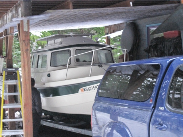

I was just looking through some other albums - whiling away a rain shower indoors - and I happened upon photos of another rack I had not noticed before. This is from the album for the 22 "Princess":
Okay, come on sun so I can get back to my projects!

Yes I have had great success with my PVC roof rack. I have doubled it in length since those photos were taken and store as much as my zodiac, two prawn traps, two crab pots,six rubbermaids a scotchman and a five gallon bucket up there and going on four seasons it has never let me down.
The PVC was cut to length and then I cut wooden dowels to fit inside the PVC, I coated the dowels with silicone before inserting then into the PVC then glued the PVC together.
The rack is very strong and has obviously greatly improved my room for storage, it was cheap to build and doesn't have much effect on the hulls tendency to roll as some thought it would.
