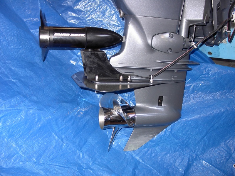

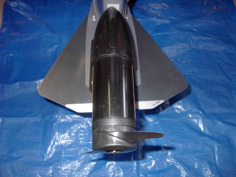

I installed a Cobra The edge Pro Planing and Stabilizer Plate, stainless steel on my 150. I think it has less drag and better performance then a permatrim.

Jay- That's the one ("The Edge" by Cobra) that I used on my Minn-Kota Engine Mounted Electric Trolling Motor set up, which gives one some real slow trolling speed options, especially for lakes and trout. It's another alternative to a trolling plate.
See: Engine Mounted Electric Trolling Motor
