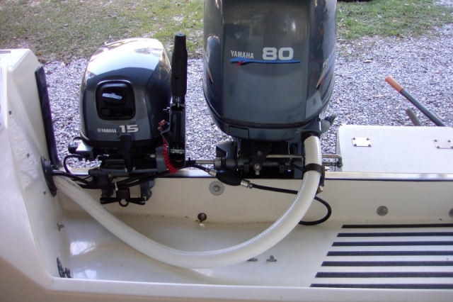

Problem is: Between my two big hounds runnin over my engine control cables, the southern sun's UV rays cookin'em and them black cables leavin nice black scuff marks in the well all the time.
For a few dollars I got 4ft of way to heavy duty water jet tubing for a jacuzzi. This stuff is way too tuff. I had to use a sawzall to slit it open. Then it was all I could do to pry it open just enough to slip all inside with two big pry bars and not lose a finger. This stuff is crush proof. If I didn't use the same fuel line for the kicker I'd put it inside too.
To do over, I would recommend the nice blue stuff for swimming pool vacuumes. Much more flexable. If I did the photo right you might see it here. If not it's on page three.

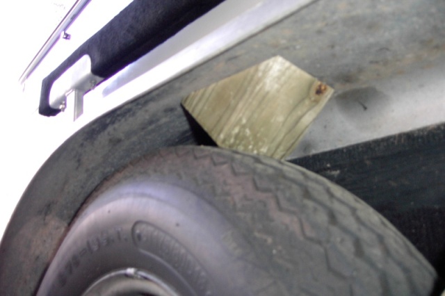

On Tandems: Climbing over the side for the thousandth time can put a strain on the fender. Put a wedge of wood under the fender for added support when parked in the yard. Once a fender gets just a little loose, they really vibrate at high speeds. The vibe usually eats up tail light filaments, too.

Chris-
I've noticed the same problem and have had to have one side welded back up.
My solution was to run a 2" galvanized fence post accross the top of the fender and attach it with U-bolts to the fender in the middle (at three points) and on the ends to the vertical posts of the guide-ons. Use fence post end caps on the ends to dress it up and cover the sharp corners on the tubes. Then jump up and down on the fenders all you want. Bulletproof to over 300-400 lbs with galvanized steel fenders. Joe.

Hi Joe,
My rig came with a tweaked fender from previouse owners. I had to remove the fender and put a few wrestlin moves on it to twist/flex it way back past the normal shape. When let go it would relax back to normal. While not quite perfect it is hangin in there. It is only a matter of time before a heavy duty fix such as yours will be needed.

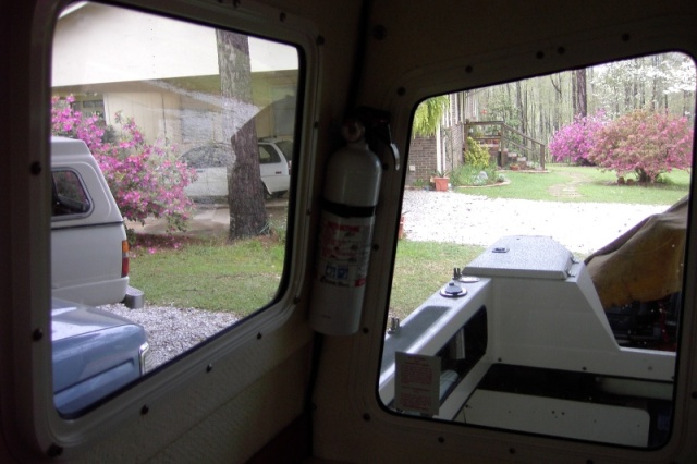

Sorry about the lighting: But if you remove the lower screw to the starboard outside grab rail, insert it thru the extinguisher center mount hole and re-install you have a very cheap mount with no new holes. I tried this on the port side but a slight curve in the cabin glass kept it from fitting. You might need to slightly enlarge the center hole.
