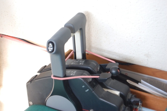

I made a small bungee loop that can be used to tether the high idle handles to the main throttle/shifter. I also use it to keep the starboard engine at 2000 RPMs so I can start the Wallas.

page two of my album shows the bungee solution that apparently more than one of us figured out. It works fine, just adjust the height of the loop on the throttle levers to avoid over reving.
