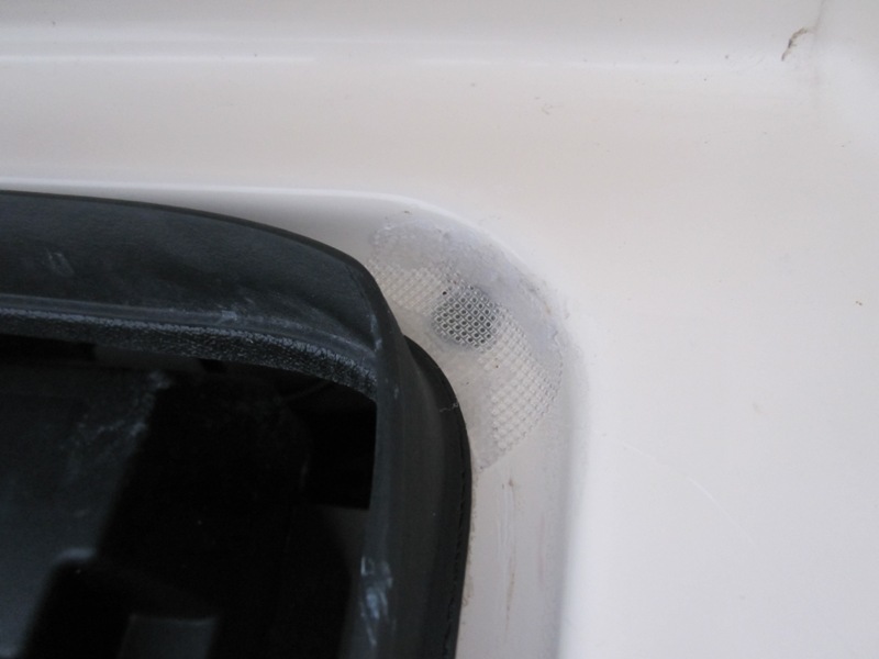

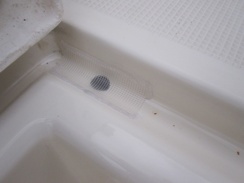

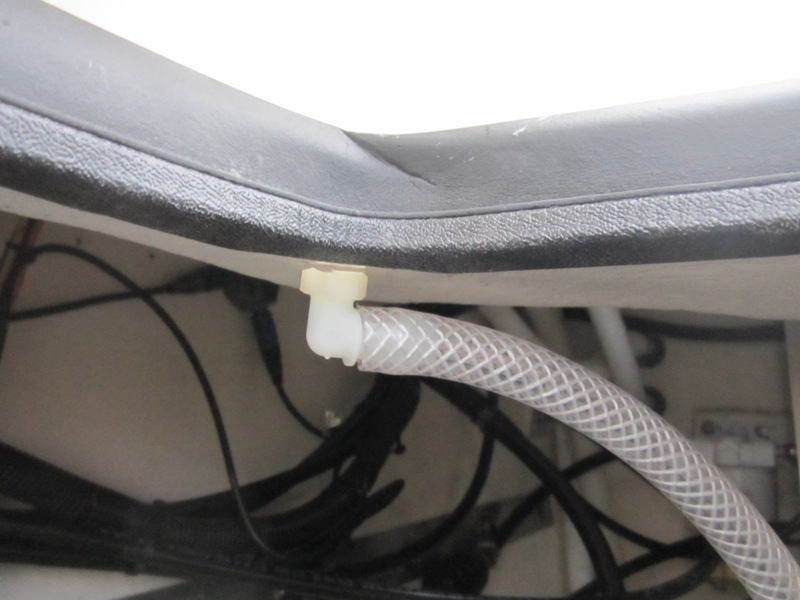

I too have been frustrated about gallons of water in the fishboxes. I decided that the culprit was three things.
1. The channels around the fishboxes are the first things to fill with water.
2. The original seals were not positioned correctly.
3. As you step on the lids, they move down, then back up creating a nice pump that sucks water out of the channels into the boxes.
I devised a four stage plan.
1. Install drains at the aft end of the fishbox channels that drain into the cockpit drain fittings. While I was at it I installed drains in the port and starboard aft corners of the battery access opening since it was constantly allowing water into the battery tray.
2. Install new seals that are positioned correctly.
3. Install rubber bumpers that keep the fishbox lids from moving when stepped on.
4. Install vents into the bilge so that air will circulate through the fishboxes.
So far it seems to be working pretty well although depending on how the boat is trimmed or how it is sitting on the trailer, the fishbox channels are barely above the waterline or are not tilted so the aft end is above the forward so some water remains in the channel. I have connected the port and starboard drains with a hard line so that if there was a list to either side the collected water would drain out the other side. So far the boxes have a trace of water in them after a thorough washing of the boat.
Here are some photos:

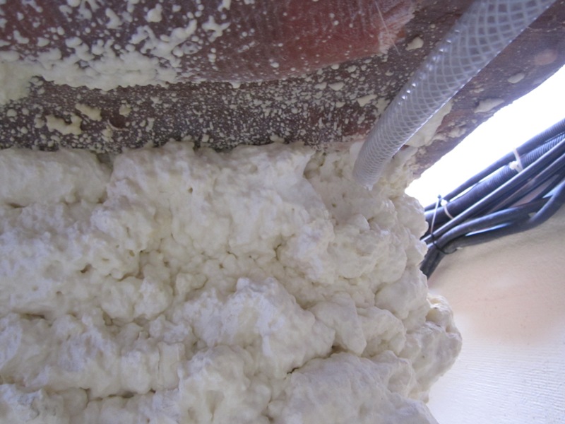

I drilled 5/8" holes in the corners of the channels, tapped them for 3/8" pipe fittings and installed 90 deg fittings with a 1/2" hose barb. I used hot glue to cover the holes with a nylon mesh so rocks, crab parts etc, would not plug the holes.
The installation of the fittings was no fun because of the insulation around the fishboxes and the limited access.

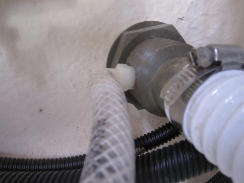

At the cockpit drain through hull fittings, I drilled and tapped for the same 3/8" pipe fittings.
The Battery access opening was easier to reach.
Good view of drain fitting.
Pipe used to connect port and starboard drains.
I don't have photos but for the vents into the bilge, I decided I wanted something I could close if I wanted to fill the boxes with fish, ice or the like so I installed plastic deck fills just under the lid catch.

Yes Mike, I think we both have the same "problem". The vents into the bilge I installed on the side just below the small plate that the lid latch catches when turned closed. /this is about 1 1/2" or so from the top.
The hard line T's into the lines right next to the fishbox channel drain fittings.
As well as the system works, I still don't like the fact that the water doesn't completely drain of the channels so I'm considering a couple of wet sumps like this.

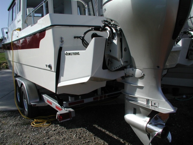

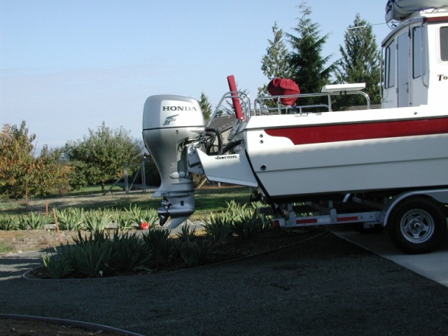

Mike,
That's the new and improved location. Here's where they were originally, and Charlie's right, they used to back fill the bilge through the bilge pump.
PostPosted: Sun Oct 10, 2010 10:27 am    Post subject: Reply with quote
That must be roughly equivalent to what our TC255's use for the shower drain and, I think, where the water heater drains when you open that drain valve. Mine seems to function fine, which is good because it'd be hard to get to under the access that's under the sink/Wallas cabinet.
Used for a fishbox, other accessory drain aft however, it just adds another electrical device/pump to the bilge pumps, macerator pumps etc that are already there. I think I'd prefer to raise the overboards for the bilge pump and macerator pump as Roger (aka the Factory) did on Dreamer. That, combines with the small drains in the fishbox channels should take care of the wet fishbox problems. I need to make my access ports bigger first so that I can get to the stuff back there.
