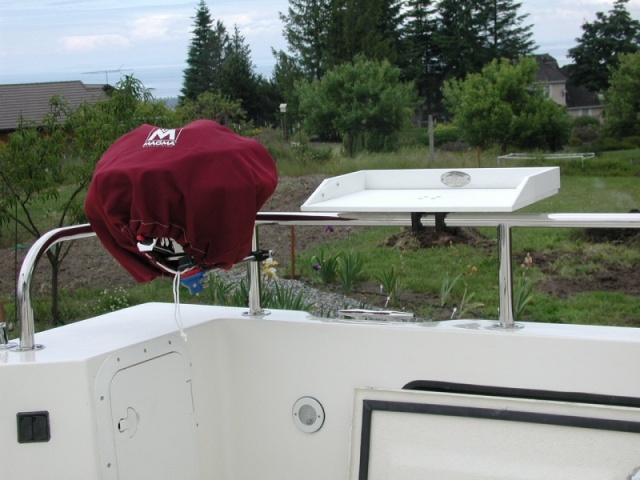

PostPosted: Fri Oct 08, 2010 8:49 pm    Post subject: Reply with quote
Dark out now, boat is in the driveway. Here's a "big hatch" on Roger's DREAMER, just under the red BBQ grill. Comes up to the deck level. Mine are a lot smaller. I'll just go measure the space I have and buy the biggest one that will fit.

PostPosted: Sat Oct 09, 2010 12:59 am    Post subject: Reply with quote
Ah, I see. Mine are the same a Roger's.

PostPosted: Sat Oct 09, 2010 3:48 pm    Post subject: Reply with quote
Guys, Photos are back. Sorry Embarassed

PostPosted: Mon Oct 11, 2010 1:47 pm    Post subject: Reply with quote
Yours may be the same as mine John but mine are way smaller than Roger's on Dreamer, see a post about 6 up on this thread, right below the red grill cover. Mine are at least 6 inches below the top edge of the cockpit. His are nearly flush (on the outer edge of the flange.).
