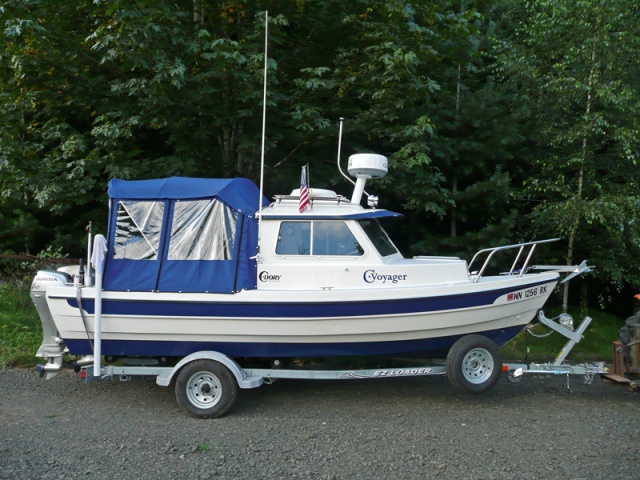

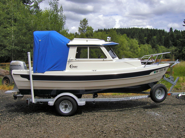

C-Voyager is 90% complete with the 2’ extension and other modifications I intended to make.
The 16’ version
The 18’ version

I gained about a 17% increase in fuel economy and there was a 17% decrease in speed.
Both of these will go up if I carry the same weight as when it was a 16.
The handling is much better. I do not need any engine trim to keep the bow down. I actually have to trim the engine for bow up until I reach planning speed.
Thumbs Up Thumbs Up My impressions and feelings about the extension and modifications. Very Happy Very Happy

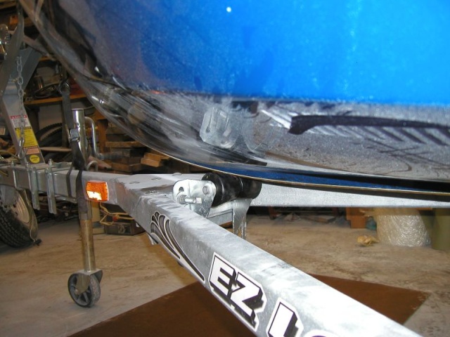

Tom – I did not extend the trailer. I moved the front post ahead 22 inches and the axle ahead eight inches. I also added a keel roller at the front V of the trailer.
Tomorrow I will have load range C tires put on the trailer. The existing load range B tires are at their limit for their carrying capacity.
I also extended the spare tire out from the trailer four inches, so it would clear the boat.
