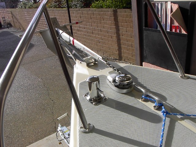

If you're having banging problems, or problems with your banging, (with your anchor, that is) it just might be partly the fault of your anchor roller.
Most anchor types require a pivoting anchor roller like the one below. It has a long enough reach to add some extra clearance between the anchor chain, and the boat.
Sometimes some anchors can be used with a windlass and the original OEM anchor roller.
Bruce type anchors because of their low center of gravity and short shank, often allow this.
It's nice to be able to use the original roller, but if the clearance is so low that you can't avoid that troublesome banging around by coming up slowly, you might look into whether an extending pivoting roller would give you some more room.
Joe.

I have the FX-16 on 100 feet of 1/4" chain + 200 ft of 1/2" three strand nylon rope powered up and down by a Quick Aires 500 windlass.
Works great with the Lewmar pivoting anchor roller pictured in my previous post.
Getting the right anchor with the right roller, windlass, and rode to all work together often involves a bit of a fine tuning after careful observation and thinking.
I've installed three windlasses now, and each was a bit of a challenge.
Joe.
Fortress FX-16 anchor, 1/4" chain, and Quick Aires 500 Windlass on Sea Wolf.

What I did notice from your last photo is that the roller on your anchor pivot is different than mine. Your's look like a flat wheel and mine is concave (forms a "v") which is very narrow and my anchor literally gets wedged in the "v" of the wheel.
-Sarge/Carl
