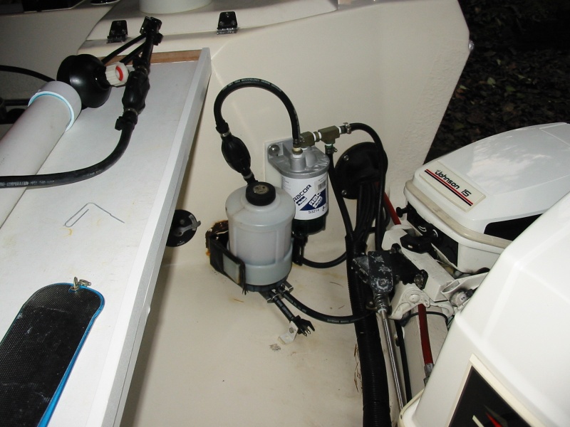

I am balancing the benefits of two stroke vs four stroke. While the two strokes are lighter, I'm thinking with the four stroke I wouldn't have to carry a separate fuel tank. I could run a line from the four stroke kicker directly into one of my tanks since the four stroke kicker would have a separate oil resovoir?
Adeline
Posts: 985
City/Region: Vancouver
Vessel Name: Adeline
Photos: Adeline
PostPosted: Sat Jan 27, 2007 6:09 pm    Post subject: Reply with quote
You don't need a separate fuel tank for your 2-stroke kicker.
