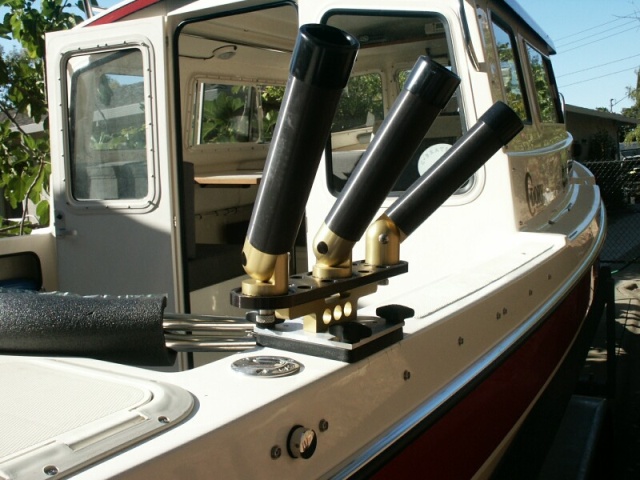

PostPosted: Sun Dec 31, 2006 7:20 pm    Post subject: Reply with quote
Pic of mine above - I've got the rod holders on the Scotty base, but you can see where the base is mounted.
The gunnels are just barely wide enough to mount the bases - triple check before drilling. I used the bases as a template, but drilled each hole slighly towards the center of the base.
Even so, I had to grind flat the edges of the fender washers underneath, as the bolts were so close to the inside hull edge.

PostPosted: Mon Jan 01, 2007 2:17 pm    Post subject: Re: Scotties Reply with quote
Wandering Sagebrush wrote:
Doug, I put flush mount rod holders in the gunnels on Constant Craving, then bought the Scotty mounts that go into the rod holders.
This is how mine was originally rigged...but I opted to remove the flush mounts, and place the base plates in their place.
I did like the lower/smoother profile of the flush mount setup when the downriggers were off, along with the versatility of being able to use other rod holder attachments. However, I found the downrigger stability to be troublesome...they rocked back and forth a bit too much for my comfort.
Could very well be paranoia on my part - I've never heard of anyone losing a downrigger with the rod holder mounts, and last I heard, one of our senior fishing pros (Dusty) used them without issue.
But...the downriggers are definitley more stable on the gunnel-attached base plates than they were on the rod holder mounts.
Regardless - if somebody wanted to try the flush mount rod holder setup first, there's no harm done assuming they are placed such that the base plates could cover the hole if it doesn't work out. There's a large hole under my Scotty base plates where the flush mounts were, but nobody would know about it unless they were removed.
