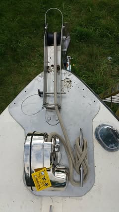

There are photos of the front deck with the winch sitting on deck and showing the chain and the center cleat.

Here is your image of the drum and chain cross the deck. How is this going to clear the large center cleat as it level winds (?) are. you going to have to guide the line to keep it level winding? I see a lot of problems with what you propose. How much line will that drum hold? Are you going with a different line? Spectra Dyneema or /Amsteel-blue? Pluses are longer line for size of reel, stronger line for measrement. Negatives, no stretch, not easy to "hand". (many others + or -.
Why not put the drum and windlass further forward? that would leave the cleat and rest of the foredeck clear and avoid the cleat and the chain as tripping hazards?

-Here is your image of the drum and chain cross the deck. How is this going to clear the large center cleat as it level winds (?)
I'have been chatting lightly with a few owners of these fine winders. Most of them like my placement all the way back at the cabin. I'm reversing the motor as it will allow the rode wind out the bottom, more or less along the deck. The winch will mount exactly on the holes to the removed Main Cleat. New cleats (if there is a need for them) will be mounted neat the Gunnels P&S. The Main cleat will not be needed any more due to the nature of the worm gears. At some point I do see wanting more cleats but I do have the others. I guess you sort of can't ever have enough cleats and attachment points.
-Are you going to have to guide the line to keep it level winding?
There won't be any need for help in retrieving the rode and it will wind level. I will eventually lengthen and change the bow-roller to a self launching and longer roller unit. It is okay with the Claw Anchor. But for the primarily sandy and mucky bottoms of my home areas I will want the Guardian up there. Currently the flukes are too long on my Guardian and hit the bow easily.
- I see a lot of problems with what you propose. How much line will that drum hold? Are you going with a different line? Spectra Dyneema or /Amsteel-blue? Pluses are longer line for size of reel, stronger line for measrement. Negatives, no stretch, not easy to "hand". (many others + or -.
Although the spool can hold 600' of 3 or 4 mm line I will be using a Hybrid line. It will look something like this: attached to the anchor will be 20-25' of 1/4" chain, then a couple hundred ft of Dyneema 4mm (or a bit less 6MM) and then filled with 3/8" or 7/16" dbl braid of some sort. They usually want 40' of 6mm or 8mm at the chain and then switch to 4mm. these dyneema ropes braid together very nicely and My new Fids can't wait to be used.
I plan to use the 150' Dbl Braid 1/2" line curently in the Chain Deck Pipe as a spare line incase I have to cut away the main. It will set there with a shackle ready to deploy (same on the stern) .
-Why not put the drum and windlass further forward? that would leave the cleat and rest of the foredeck clear and avoid the cleat and the chain as tripping hazards?[/quote]
The closer you go to the anchor roller ring (yes a ring is recommended) the more you open yourself up to the possibility of tangles on the winch spool.
The goal will be to truly not need to go forward to set the anchor.

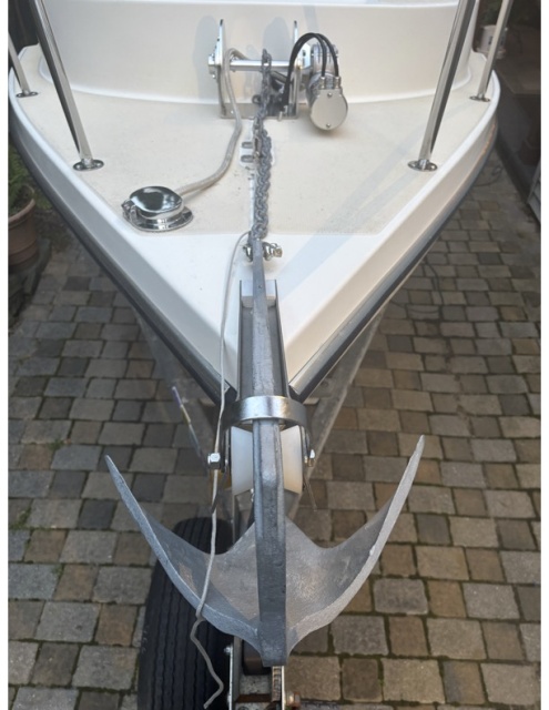

[img][/img][img][/img][img][/img]
Yes, I called the factory today and they said it works well either way. They don't place a + or - on the controls, not knowing which way the winch will turn. My opinion is that feeding the rode out the bottom creates less tripping and feeds in a straiter line which will help for a nice deployment. A small pad may be nice to protect the deck from scrapes from the chain.
See how Mark Wharton handled his challenges in the photo up to.
