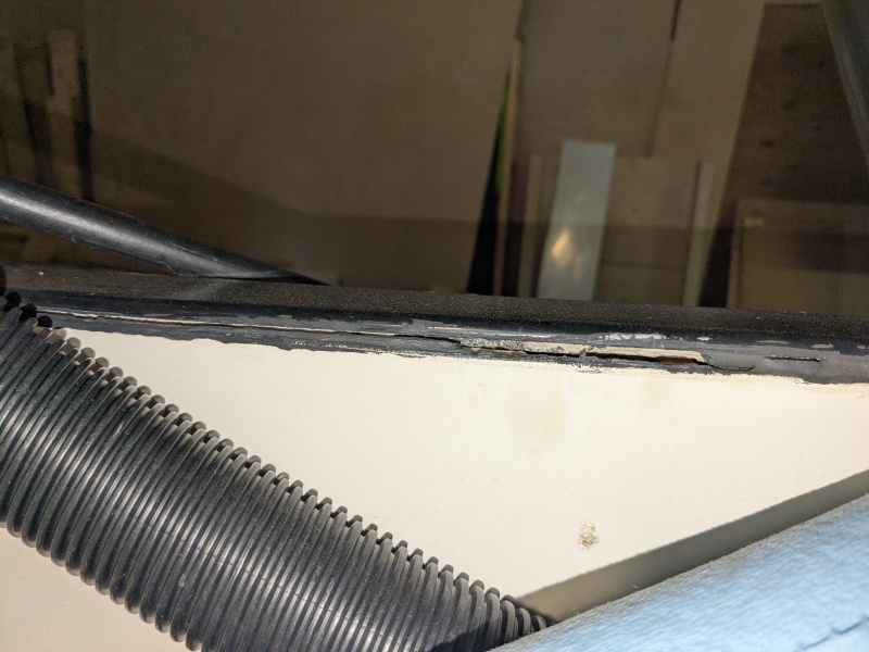

I've discovered a crack in the fibreglass beneath the black plastic transom cap on my 2004 22 Cruiser. On removing the cap and inspecting further, it's clear that water's gotten into the wooden transom core.
I'll investigate further, and plan a repair. While it's a disappointing discovery for me, I can at least add something positive by keeping a record of my diagnoses and fixes here, in case they're of use to others. I'll also plumb the considerable collective intellect here for guidance.
My first, and perhaps most important, note to others - carefully examine your transom for potential separation of the cockpit and hull fibreglass skins. On my boat, anyhow, there was next to no material joining the two, but the adhesive used to attach the plastic transom cap partially obscured the crack that must have been steadily forming. No matter how much water intrusion I find, it would surely have been less (or prevented altogether) with more careful attention to this.

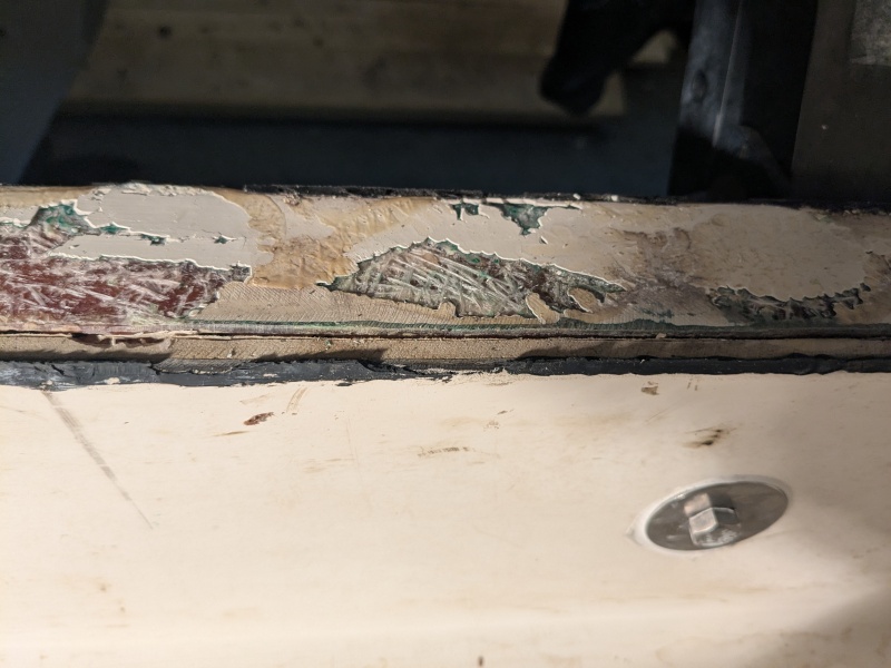

Photo below is of the cockpit side of my transom, after I scraped away some of the black adhesive to get a better look at the separation between the fibreglass skins, revealing the core.

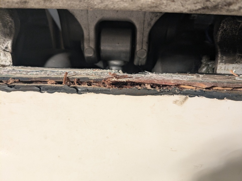

My initial take was one of only moderate concern. While I could see core through the crack (bad), it appeared to be something other than wood (good?). It was a light-coloured material, that I could gouge out with a screwdriver blade. Foam? That would be good - perhaps I could get away with a gap fill and re-skin repair like mutski's (http://www.c-brats.com/viewtopic.php?t=31043).
Thinking this, my next step was to remove the black plastic transom cap. It proved to be attached with remarkably stout adhesive, and removing it took away chunks of gelcoat, and even down into the fibreglass itself. Quite a mess. The cap also snapped in two as I removed it.
Removing the cap also showed how large the crack was, and how little material was actually joining the inner and outer fibreglass skins. As others have found (with this particular vintage of C-Dory?), there was almost no material fixing the two skins together at this joint. I really like my boat, but this was a disappointing discovery - it's a pretty mission-critical spot to seal this flimsily.
The second bad surprise was beneath the motor mount. Poking into that section of crack, it was obvious there was wooden core in the transom, and it was definitely waterlogged and rotten.
[/img][/u][/url]

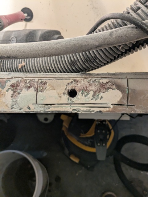

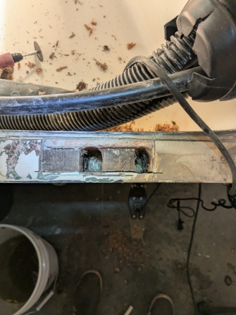

My next step was to evaluate how far along the transom top there was wet wooden core. I drilled a series of vertical test holes through the top of the transom, from left to right. While the worst rot was centred around the main motor mount, the core all the way along had at least some moisture (if not overt rot). This appeared to extend as deep as my drill bit (~2").
I left off last night having started to remove my kicker bracket (I'll need a second person for the lower bolts), and I've removed both fuel tanks. My next move will be to pull off the main motor. In aid of this, I'll set up a chain hoist above it, holding the load on a three laminated 2x4s bridging as many ceiling joists as I can span.
Side note - I was worried about successfully removing the fuel tanks, as disconnecting the fill hose is noted in many C-Brats posts to be a mightily difficult task. It certainly started that way, but then I changed approaches - I removed the brackets holding it in place, budged it away from the transom enough to give some overhead clearance beneath the splashwell, then levered it up and over the inset bolts that held the inner bracket in place. Once I'd done that, I could rotate the whole tank around into the cockpit while still attached to the fill hose. At that point, I could use gravity to assist me in removing the fill hose from the tank, which made the operation pretty easy.

I did a deeper examination of core at the top of the transom, using a longer, larger-diameter drill bit. I did find solid, dry-seeming balsa all the way along the transom top, from about 2-2.5" down.

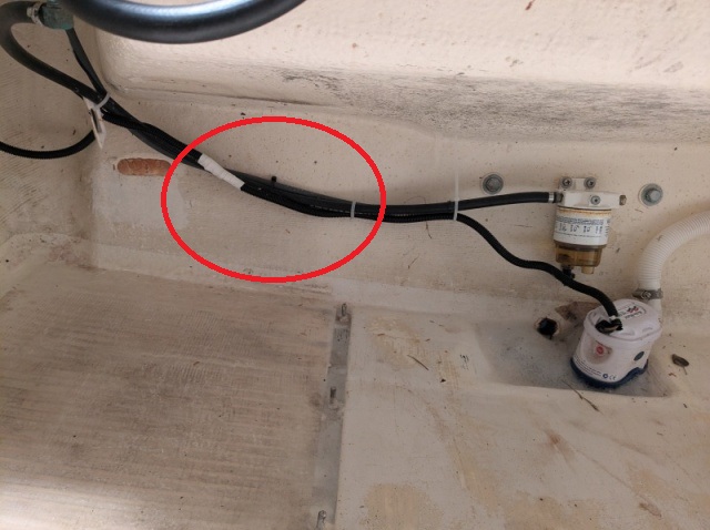

I also cleared away the fuel tanks, cleaned up the years' worth of grunge under them, and investigated the inside of the lower transom there. Tapping with a hammer, I could easily detect a dull-sounding area of hull behind where the starboard fuel tank had been (red circle in image below). The fiberglass there is not firm; it has a small amount of give when pressed, as if it's separated from the core. Tapping that area from the outside of the transom also gives a duller-sounding knock, though I struggle to feel confident in actually detecting a difference. Outer hull fiberglass in that area is firm - no difference from elsewhere on the hull.

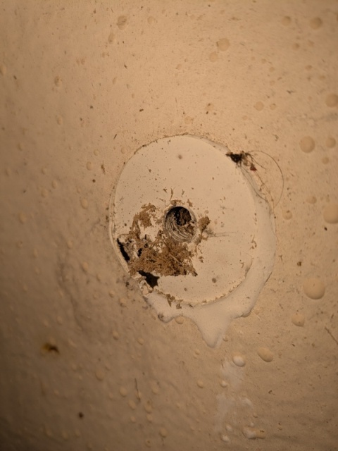

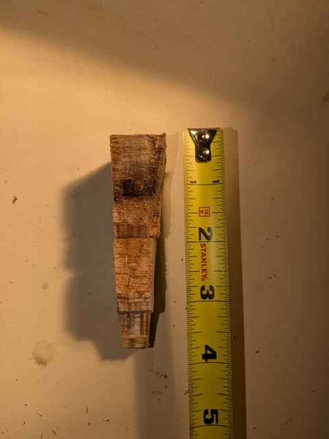

Some more investigations last night, to determine whether it is indeed just the top couple of inches of the transom that's wet/degraded, or if the issue pervades further down.

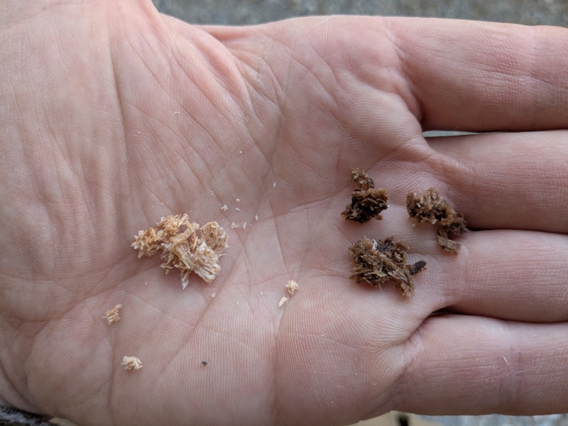

I removed a section of fibreglass at starboard top of the transom, which exposed the predictably-wet balsa core. From there, I bored out a couple of 4" deep sections, isolating a 1" wide section of core to pop out as a horizontal sample of the transom core. Easier said than done, but I did manage to extract a 3 3/4" piece to examine.
The core sample showed:
- top 2": wet, deteriorated balsa, with delamination from cockpit fiberglass
- 2" to ~3": damp but solid balsa, tight bond to fiberglass
- 3" and deeper; drier solid balsa, tight bond to fiberglass
I doubt a moisture meter would find this to bottom layer to be bone dry, but it feels solid to my prodding investigations, and I'm heartened by the rapid transition from soggy at the top layer.

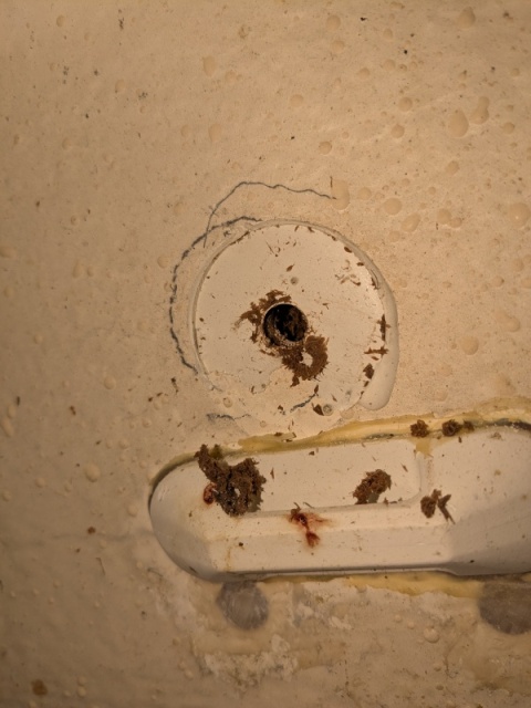

I continued investigations of the lower transom, removing all kicker bracket hardware and one lower main motor bracket bolt. Good news - boring out the main motor bolt hole (starboard side) produced whiskery dry balsa shavings - no moisture here!

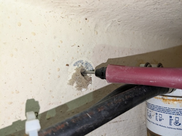

Less good - the lower kicker bracket bolt hole furthest to port produced soggy brown balsa when dremeled out. However, the lower kicker bracket bolt hole toward the centre of the boat was pretty good (though not perfect - some dampness). Moving up to the upper kicker bracket bolt holes, the port one was dry, the centremost damp. These uppermost bracket bolt holes would be addressed by removing balsa core from the top of the transom.
I'm reading my bolt hole findings in the lower transom as patchy damp related to poorly-sealed hardware installation - something could hopefully address with section-specific replacement of wet core patches with dry.
I also reapplied myself to the delaminated-sounding section of the lower transom behind the starboard fuel tank. On further inspection, this is perhaps a red herring - the layer that's delaminated feels papery-thin, and can be flexed with a stout finger press. It also protrudes a little from the surrounding fiberglass skin. Comparing to the thickness of the cockpit fiberglass skin visible at the top of the transom, what's going on here must be some kind of delamination of a thin layer of outer fiberglass from the thicker main cockpit skin. I'm not certain what the cause or implications of this are, but I'm (cautiously) less concerned about a catatrophic delamination between balsa core and cockpit fiberglass.

Posts: 21606
PostPosted: Thu May 08, 2025 2:44 pm    Post subject: Re: so soon Reply with quote
Nancee wrote:
Just as an inexperienced c brat, is it normal to have this much damage on this age of boat???
Transom problems are relatively rare in C Dorys. If the boat is in a freeze thaw cycle winter environment and water somehow gets into a crack then this can occur. I would say that all in all, C Dory boats have a little less transom issues that most boats their age, if they are still in use.
Any hole drilled a cored fiberglass/wood/fiberglass laminate, should be sealed with epoxy. Just a dab of 5200 is not enough.
In this case it appears that the wet core is not far down into the transom, and the fix should be fairly easy.

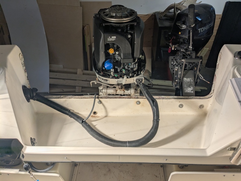

Over the past couple of evenings, I’ve lifted off the main outboard, removed the transom cap and started pulling out wet balsa.
It’s not looking good.
I’ve worked by way 6” down in some places, and except for a couple of areas I’m still encountering wet balsa. In some cases, it seems moisture levels are increasing (to the point of pooling). This could be from bracket mounting holes in the fiberglass, which were not epoxy-sealed. Core bond to the fiberglass is poor or nonexistent. I can see several places where core discolouration follows sipes in the balsa core downward. I haven’t detected any epoxy in the sipes (but perhaps this is not out of the ordinary).
I’m considering my options. Informing them – I’m in a small, remote and landlocked city. Materials are hard to come by, and can take considerable time/expense to arrive. There’s one fiberglass shop in town, but others’ previous experience is he won’t tackle a job like this. I’ll need to do most/all of whatever the main steps are myself, and carefully plan in advance what I’ll need. I will be down south late next week and driving back up with a trailer, and so do have an opportunity for marine-supply shopping. I’m hoping to have a plan and a materials list by then.
Bob – I value your suggestion of going at a full-transom repair by removing the outer skin. I’m also very hesitant – I think I can make the repair, but suspect it would look awful once I was done with it. Before putting a saw to my boat, I’m doing a version of measuring twice – what other options do I have?
As one alternative, I’m considering doing this in two stages: 1) remedying lower transom core by removing the inner transom skin below the splashwell and re-coring from the inside, and then 2) repairing the top ~6” (splashwell and up) from the top, by sliding in some (well-slathered) core material and subsequent clamping to develop a consistent core-skin bond. I’m considerably less concerned about esthetics of the inner transom skin (below the splashwell) – this area’s mostly hidden by fuel tanks. Understanding outer transom removal is the go-to; are there reasons to abandon this alternative?
