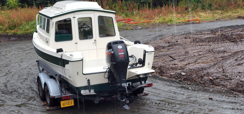

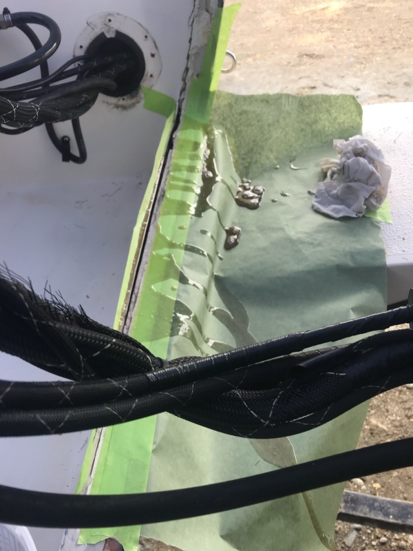

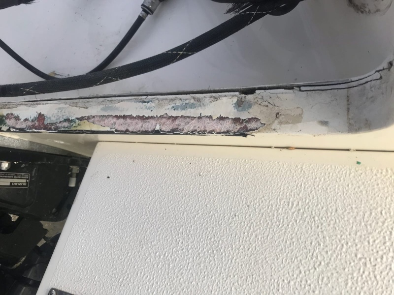

I just got my 2005 22-Cruiser back from the shop after discovering the forward edge of the transom was delaminating... the fiberglass was separating from the foam core. I originally thought I had done the damage, but when I looked at photos from when I bought it in Washington, the crack was already there.
The shop worker told me it's a common problem with production-grade outboard boats. The C-Dory is made from two fiberglass molds, one for the hull and one for the top-sides. The joint between the two pieces runs down the top of the transom, where in my boat, they are sandwiched around a piece of medium-density closed-cell foam. The gaps were filled with putty, the top of the transom faired, and the black plastic trim hid the joint. It's a weak spot, because the two pieces aren't fiberglassed together. He said it's likely the torque of the bouncing outboard motor pulled the layers apart when the trailered boat hit bumps in the road.

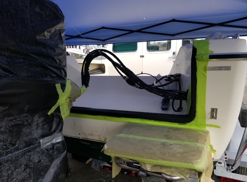

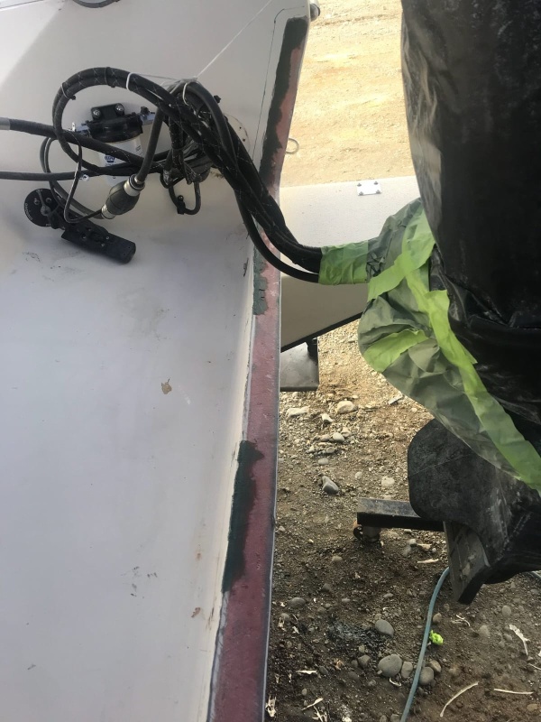

He said he found minimal water intrusion, and the transom was still structurally sound. He removed the plastic trim, filled the voids with a pint of fiberglass resin, put three layers of fiberglass over the top of the transom, then painted it black to mimic the plastic trim.
I feel l like a C-Brats weenie for hiring someone else to do the work. But we've entered the rainy season here, and I have neither a dry place to work nor the tools nor the experience. I just wanted it done so I could keep on playing. Hopefully, it's stronger than when it left the factory. I want to go halibut fishing on the next nice day!

Yes, I've learned this is a weak spot on C-Dorys with the black plastic cap. I've found similar on my '99 22 Cruiser and, barring the plywood core needing more than minimal repair, I plan to grind off the top (previous owner had applied epoxy over the joint), feather the sides, then lay a fiberglass cap over everything. I had intended to also replace the black plastic cap to give added protection, but the factory no longer uses the cap. They now seal the joint with fiberglass, as it should be. I suspect that many of the boats with the black plastic cap may show similar.

This is mostly correct. There is fiberglass on both sides of the core of the transom--the fiberglass for the deck house, cockpit, gunnels etc is placed on top of the hull. all through the boat, and then glassed on the inside to make one of the strongest hull to deck joints in the industry. In the case of the 22, it is the spashwell glass, should be next to the inner layer of the hull. Then there should be a fiberglass wrap over the top of the cap--and some of the boats are made this way.
I would have used epoxy resin for the Joining of the splash well molded part and the inner glass of the transom because of its better secondary bond. If there was any void, then glass fibers/thickening compound should be included. If indeed the foam core had separated, then there was some failure of the core to inner glass of the transom bond. What you have done will work fine.
2005 was the high output time of the Reynold's ownership of C Dory, and there were some minor quality control issues. There may have been some short cuts. I have dealt with this issue on two of the C Dory 25's. More recently I worked on a boat where the fiberglass of the splash well was formed with about 1/4" void between the 1/4" thick glass of the splash well, and the inside layers of fiberglass of the transom. The 1/4" glass had been crushed, and it appeared as if there were a transom failure. The transom was fine. I filled this 1/4 void with multiple layers of 6 oz cloth and epoxy resin. This made the joint stronger than when the boat was built. At the same time I removed core around the motor mount bolt holes of the transom, and filled this with thickened epoxy. Now the pressure of the bolts (I made a new bar of 3/8" thick aluminum about 3" wide between both upper bolts, which spreads the load out over a much wider area.

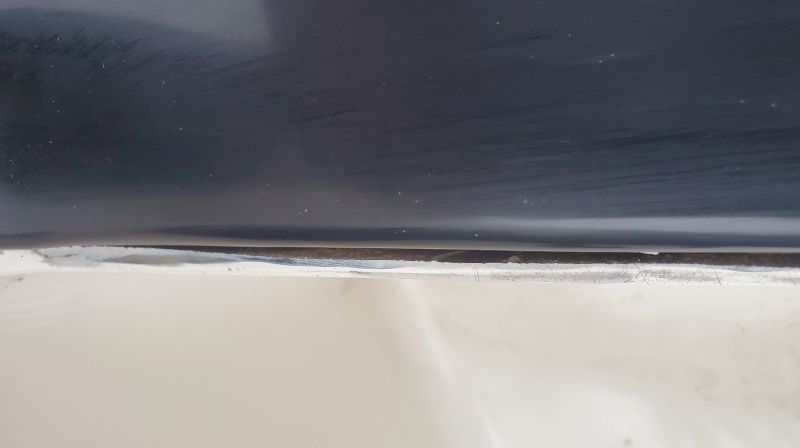

Before you start ripping and tearing... I could tell I had a problem because there was an open crack at the inside of the plastic cap. When I got to looking, I could feel the top few inches of fiberglass inside the splash well move when I tapped it. I'm not sure I'd go exploring unless I found indications of a problem.
