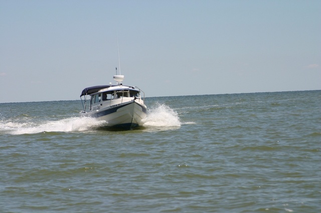

What angle do you think the water line makes with the water when a CD 22 is on a plane?
The Raymarine I've just bought scans in a horiz plane +/- 12.5 vertical degrees. I want to introduce a dip in the radar when at rest so that on a plane the sweep is horiz.
The 5 inch high mounting bracket has holes to attach to cabin top 5 inches square. So, I have to solve this equation:
x = inches to raise rear to achieve desired angle of dip over 5 inches
y = angle of dip in degrees
x = 5 tan(y)
So, another way to ask the question is what is y?
What have some others done?
Does the bow pulpit show up on the radar when tilted down, say 10 degrees?

George, a lot depends on how you've got your engines set and how you load the boat. Mine has a few degrees down tilt, see pix
and is not adjustable. You get some shims with the dome (I think) that you can put under the aft mounting bolts to give you some tilt if the mount doesn't have a built in tilt. Mine does.

If I can get out tomorrow with a level and a ruler I can get the tangent of the angle when on a plane. However, I'd rather be working on the installation.

I too bought a radome strut mount. Mine has a built in 5 degree tilt and it seems to work out extremely well, regardless of how I load the boat.

I'd don't recall exactly how high the mounting bracket is, but probably about five inches. As far as I can tell there is no shim to change the angle; just bracket on the cabin top, and the radar antenna.
I have had no complaints whatsoever with the radar performance as installed. In fact, my recollection is that when in-the-soup we usually in a displacement cruise mode, hence no appreciable plane angle.
I think the only issue might be exactly where (ie. how far aft) the unit is mounted, but again I'd say it's simply back far enough as to avoid the downward sweep of the forward edge of the cabin roof. Did that make sense??

If you're calculating all this because it's part of the pleasure for you that's just great; it's part of what makes this boating thing so much fun for different folks.
However (to keep it simple), if you get a 5" Power Tower (now Seaview Power Mount; I typically use the 5" forward leaning Pathfinder (Raymarine) model) and mount it on the cabin top directly and then mount the radome on that you'll end up with a very nicely performing installation. At speed where you typically want a little more range for picking up distant objects the radar will be very close to level; when you drop down to slower speeds when "in the soup" or at night the radar then is slightly down getting the best returns on close in objects which is exactly what you want. Even at slow speed you're still near the middle of the 25-degree range and you'll still pick up objects quite well at distance (especially the big guys you'd like to stay away from!).
You can calculate all this very precisely but the reality is that on a small boat such as the CD22 just the load (fuel, water, passengers, etc), the use of engine trim (and/or trim tabs), and pitching from sea conditons can vary the angle far greater than the shimming angle you might incorporate. The radar scanner is meant to be pretty forgiving as they're used on small power boats and sailboats which (except under very ideal conditions) are never "level".

I got rid of all the formulas , I installed the radar on my arch, stood behind it and it looked good . Then I put the boat in the water ,did the radar set to factory specs , then proceeded checking what the screen was seeing . Worked 100%. Use it in good weather to practice , and it is working find.

Most answers seem to fall in two catagories: it depends…, and doesn’t matter. Both are probably (real-world) good answers. For the record, I did notice that no one answered the question. Les has the experience to know what works. Me, I have no experience so I have to rely on thinking about it.
My thinking produced these results: Most of the time when I need the radar, I will not be on a plane – no dip needed. Sometimes, I will be on a plane and using the radar for monitoring converging vessels. While the +/- 12.5 degrees may be all I need, I see no harm and maybe a small benefit in building in a little dip. I plan to dip 5 degrees.
With respect to the “fancy math”, I think raising the radome 0.4374 inches five inches from the pivot point will give me 5 degrees. Exclamation Question Anyone?

I'm thinking of installing the radome so that I can carry my dinghy inflated and upside down with the bow forward of the radar.
Three issues come to mind: Will it work, will the signal damage the dinghy and if I move the radome back to allow room aft of the light pole for the tube will I have positioned it too far aft?

You won't see the bow rail on the radar.
It never hurts to optimize things; I just wanted to make sure you were doing it out of your desire to be persnickety about it and not because if you didn't you thought your radar might not work.
I believe that the most difficult thing is determining what you think level is (fore and aft). If you believe that the cabin top represents "level" then the easiest thing to do is to purchase a 5-degree radar mounting wedge (there are a couple available in the West Marine catalog). If the cabin top isn't level then I'd get one of those angle gauges from the home building center hold it at whatever angle you determine is appropriate and mark your wedge base material. Seems easier then the math! Smile
To the best of my knowledge the radar won't hurt the dinghy (I've just never heard anyone mentioning the possibility including the radar reps and lots of dinghies are near radar transmissions), and the dinghy won't interfere with the radar unless the motor plate (if there is one) ends up at the same level as the scanner.
The Power Tower is mounted on the flat portion of the cabin top; not on the sloping section just aft of the anchor light (just making sure!). Moving the dome back far enough to allow tube space will not cause problems for the radar.
The full length of the cabin top (from tip of visor to the rear overhang) is about 8 feet. The anchor light is 12" behind the forward edge of the visor and leans back at 15-degrees; this leaves roughly 6.5 feet of dingy storage space with the anchor light in place.
This is exactly the situation that lead to the development of the radar arches we designed. Once radar became all but standard I fought the conflicting space requirement (anchor light, radar and dinghy) continuously. I don't "push" any particular solution; it's for each person to decide what works for them but here are my thoughts on the arch...
