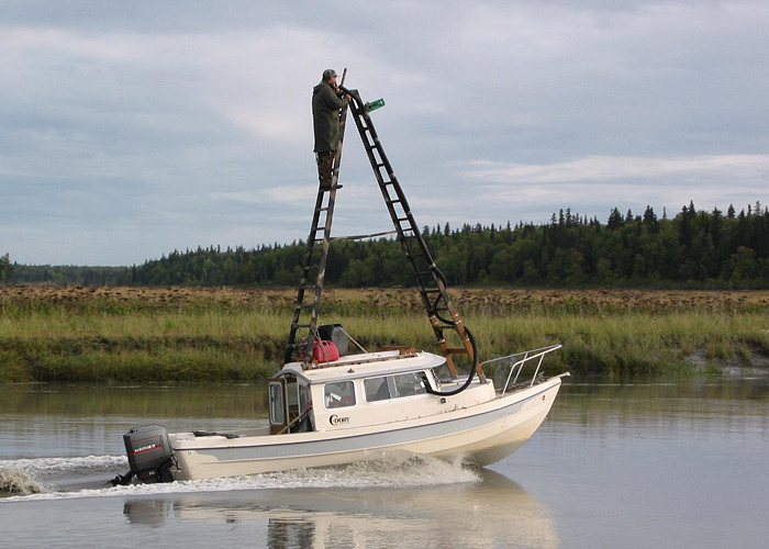

Of course, the most famous is:
Seriously, read the threads. There are some very good cautions offered by some very knowledgeable people.
