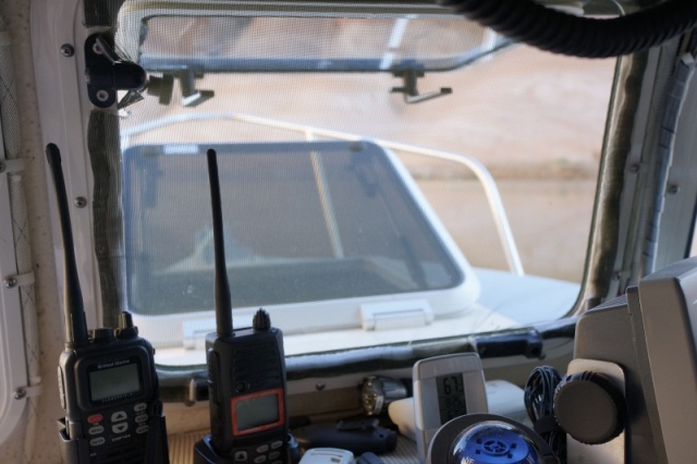

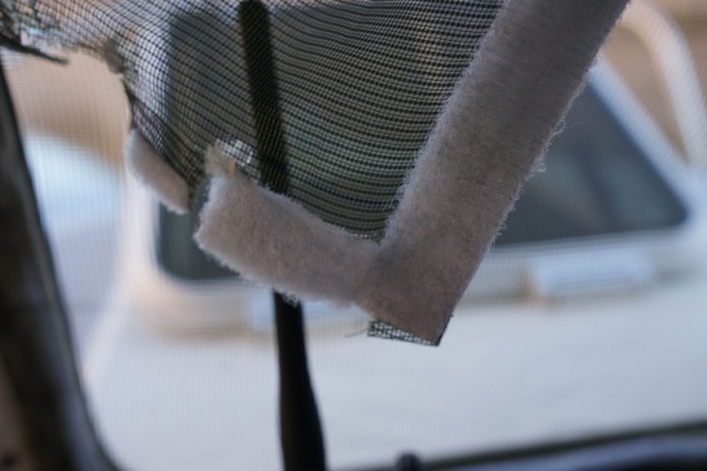

You don't need to buy a screen. I had given some away a couple of years ago. I use "Army no see-um netting"--had to buy a full tent sized piece. Fiberglass window screen works very well, Put velcro on the around the hatch on the overhead--we used the sticky back white velcro, and it has been on about 5 years. We secure the velcro on the on the net with hot glue.
We use the same technique for the front opening window. These screens are much easier to stow than the fixed aluminum framed screen.
Here is a photo of our front window "no see-um net" Cut outs for arms and latch cams.
Close up of Velcro on the screen:
The factory screens work best with a frame designed for them.
