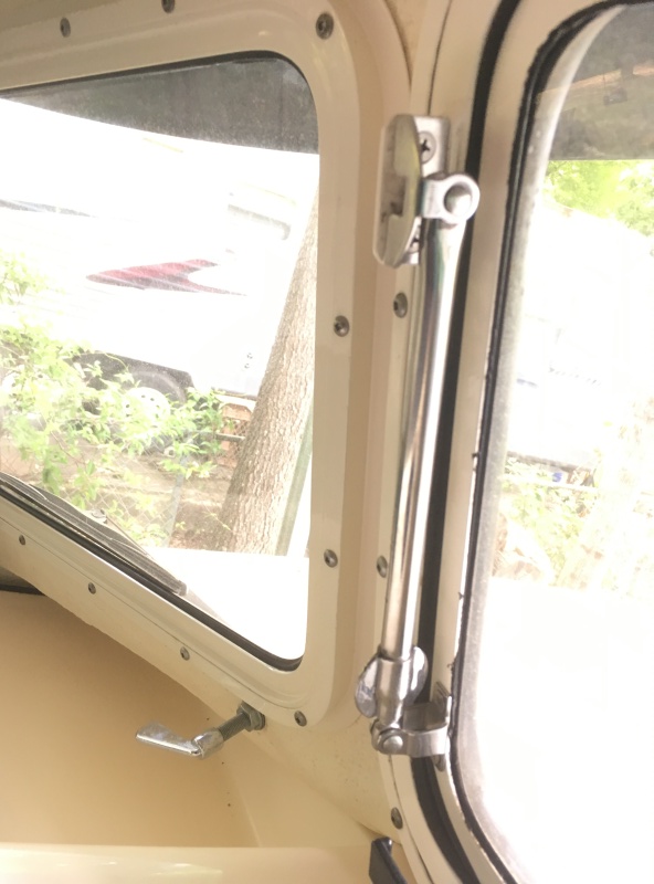

Just so there's no confusion.
This is what I had on my adjuster

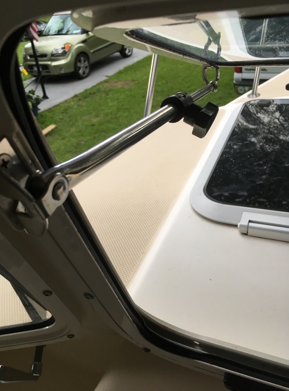

PostPosted: Sat Jun 16, 2018 12:15 am    Post subject: Then this Reply with quote
Then I went to this by adding the knob hardware to the old adjuster rod.
