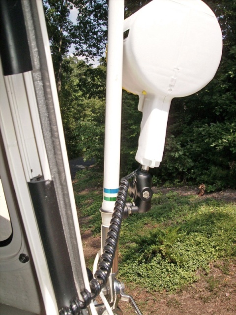

You would think after all these years as a Brat I would know how to post a picture from my Brats Album to a reply. I can create a link.
I used a simple bracket attached to my antenna to secure a hand held spotlight that can be directed out the window just outside the captains chair. Works great and is inexpensive. Can be removed and used with any 12v plug in socket.
Swee Pea
http://www.c-brats.com/albums/SweePea/PICT0472_1_edited.sized.jpg
http://www.c-brats.com/modules.php?full=1&set_albumName=SweePea&id=PICT0473_1_edited&op=modload&name=gallery&file=index&include=view_photo.php

PostPosted: Sat Jul 28, 2018 10:38 am    Post subject: Spot Light Reply with quote
Figured out how to show a picture in a reply/topic.

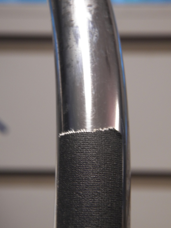

jbdba01 wrote:
I removed the paint but will be replacing it with plastic-dip.
I used gaffer's tape. It is non-reflective and waterproof. Lasts at least 4 years if boat is kept outside. Removal will leave some residue that is easily cleaned up with acetone or "goop remover."
Apparently, I'm the only one that is bothered by the sun reflecting off of the bow rail. The 1 inch tape is just right for covering up the rail surface facing the helm and is basically invisible from other angles. In the picture, you can see the difference between the reflection of the overhead lights in my garage. Really makes a difference with the sun (and the search light).
