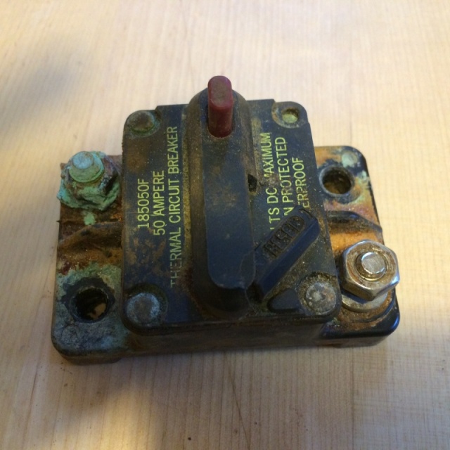

We were last out in August 2015, and everything was working fine. Daydream has been in our garage since then with the shore power plugged in. Fast forward to today, I pulled the boat out into the driveway, no horn, no lights, no accessories, no water pump, no nothing controlled from the panel at the helm. But the charger is working, batteries are fully charged and not from solar because boat has been in the garage. There is a big breaker that sits right by the starting battery, and it is popped (I think it is popped, the little lever is out) and it won't reset (which I think I would do by pressing the little lever back in, but it won't stay in). Is this breaker indeed the culprit, and if so, how do I deal with it? What could have caused it to pop in the first place, there has been no load on the 12 volt system at all.
PostPosted: Tue Apr 12, 2016 9:10 pm    Post subject: Reply with quote
OK, mystery solved I think. I just pulled the breaker, and here is a pic:
The terminal connector on the cable that was connected to the really corroded post was broken. Broken terminal connector equals broken circuit, no juice!
The breaker MIGHT still actually work, but given its corroded appearance, I am going to replace it. It has been down there for eleven years now, time to retire it!
The bigger problem for me is how to put a terminal connector on the cable. I think the cable is probably AGW 4, at least it looks bigger than the AWG 6 I have on the solar controller to batteries on the fifth wheel. Off to LFS tomorrow I guess!

PostPosted: Tue Apr 12, 2016 10:09 pm    Post subject: Reply with quote
You also have a poor location for that breaker, based on the corrosion. It should be up out of the bilge area. Or, maybe this boat spent some time underwater?

This boat has spent NO time underwater! The breaker locations is right where C-Dory decided it should be in 2005! I wonder how many other CD25s of similar vintage have the breaker in this location? It is actually not "in the bilge," it is on the raised fiberglass tray the starting battery sits on. Still, this is an area where moisture is to be expected!
Posts: 21468
PostPosted: Tue Apr 12, 2016 11:05 pm    Post subject: Reply with quote
Yep, Pat you are right to replace the brakes. There is a lot of condensation, from bilge water in the 25, and unfortunately this is probably the best place to put the breaker--should be within 7" of the battery. I would do several things. Replace the same breaker but with a 60 amp breaker. I would either get one of the "hit the spot" with a hammer swagers, (but use Vise Grips or a vise to do the crimp. Or buy a hydraulic hand crimper from Harbor Freight.
When you assemble the circuit coat the terminals and fittings with conductive non corrosive grease. Spray the complete switch with "corrosion block". Every year, check the fittings, and re apply the grease and corrosion block.

Hi Pat, Sorry about the electrical issue. Better in the driveway than in the anchorage off Stuart Island. Looking at the picture, your fuse was in about the same shape as mine last Spring when it was replaced at Roger's Marine in Portland. They said replace it or it would go bad. Guess they were right.
Mine is in the stbd lazzarette, high and dry, but still looked "crusty" and ??? So I took Their advise.
