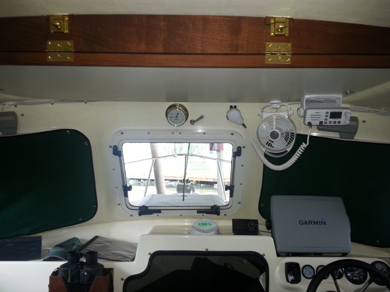

PostPosted: Wed Oct 23, 2013 12:59 pm    Post subject: Reply with quote
Reviving an old but relevant thread. I added a $40 manual wiper to my center opening window last weekend. I'm kicking myself for not doing it sooner. The install took 15 minutes. The window opens fully with no interference from the wiper arm at all. When not being used, the wiper parks to the side so it's not in view. Granted, it's not a pantographic arm, but it clears an adequate area of the window so I can finally see!
Sorry for the bad cell phone picture. The wiper handle is next to the clock and the wiper arm is shown mid-sweep in the center of the window. The handle looks far away, but I can reach it from the seat.
