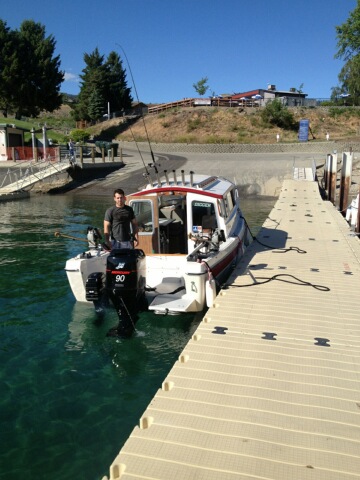

Digger set up our boat, but I can try to get you more info and pictures and my own thoughts after experience with a couple boats that had both a main and a kicker.
first, i have a 90hp OB as my main, and a 9.9 as well. the swim platform to starboard, kicker to port. the 9.9 is quite economical in my opinion. ours is a 2stroke (vs the OB which is a 4 stroke). that might be a nice upgrade some day.
things I love about the setup that Digger did before we bought the boat:
    Kicker runs off a removable steering linkage to the main OB. I can detach them and trim up the kicker when underway for better economy on the main ob.
    second helm added in cockpit and throttle control for kicker makes trolling around super easy. fishing from the cockpit vs the cabin is very nice.
things that I we had on the Lund that would be nice but we do not have now:
    electric trim at the cabin helm for the kicker (do not have elec trim on the 9.9 now)
    throttle control for the kicker in the cabin (currently only have control aft)
    4 stroke kicker (means 1 gas tank)
those are small things though and right now I can say the current setup is sweet Thumbs Up I have had this boat on the water 23 days so far (and I trailer it, dont moor it) since May and I love it.

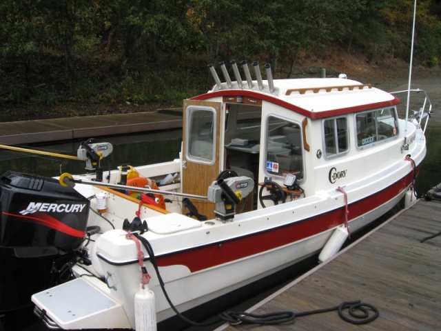

I have a 6hp kicker, mounted on the starboard side of my main, a 115hp Merc. So don't know if they'll help much, but look at the photo section for Midnight Flyer, as I have photos there of my setup. Colby
