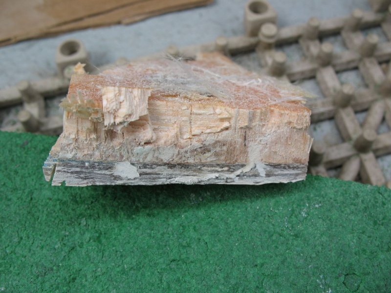

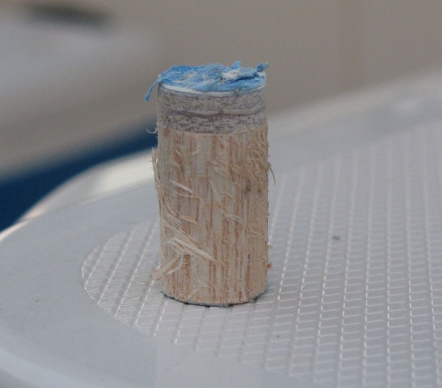

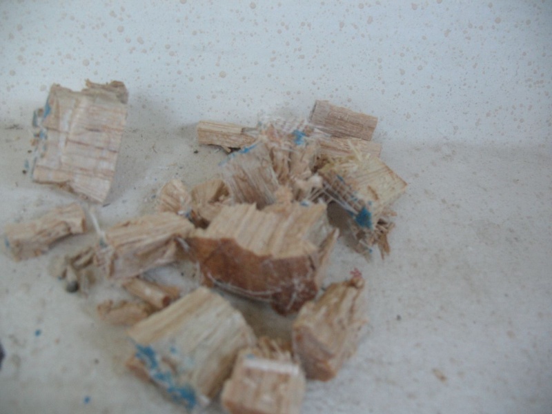

Just to round out the collection of transom core materials, my 2002 is balsa. I've now drilled into it pretty much all over and have not found anything else (what I mean is that in the course of trim tabs, Mini-Jacker mounts, transducers, and swim platform, I've covered the map pretty well; not that I'm just drilling willy-nilly Mr. Green)
Here are a few photos of (dry) balsa core - does yours look like this?
Damp balsa will look similar, but darker; and rotten balsa can become really tobacco-juicy looking or even black and soupy (of course by then rotten plywood might look similar).
When I mentioned pulling out "tufts" of core with a dental pick - that applies to balsa, but probably not plywood (I've never worked with plywood core though).
