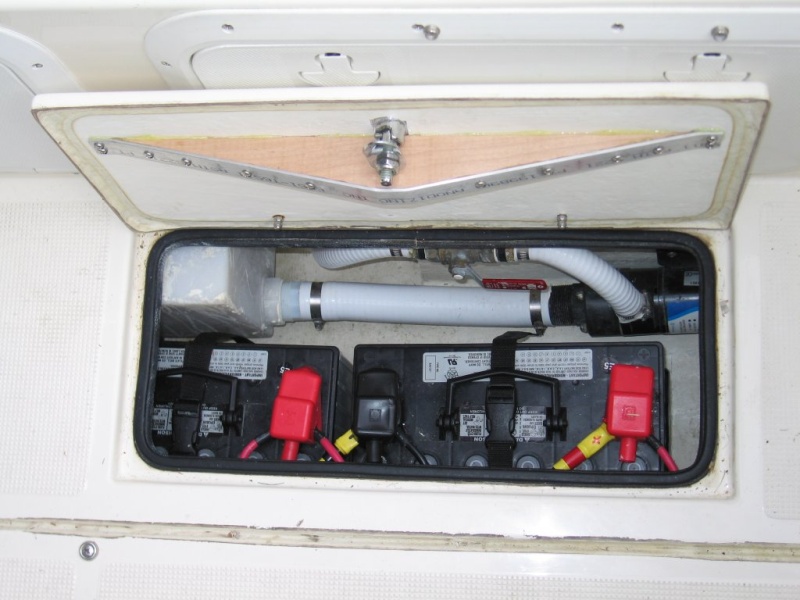

JamesTXSD wrote:
Good luck with the projects... once you get 'em done, the boat stays pretty water-tight... well, except for those hatches on aft cockpit floor. Rolling Eyes
Jim,
Did you ever see Hank Brooks' solution for the aft cockpit hatches (he had Sea Skipper)? If not the photo album may still be here. If that's not the case I can try and recreate the fix.
Les

Was it the aluminum brace added to the underside Les?

Hi Les,
Yes, I did see those photos and visited with Hank before he sold Sea Skipper. He gave me some good tips when we ordered our boat. I haven't done anything with our cockpit hatches... yet.
Posts: 5927
PostPosted: Fri Oct 14, 2011 10:04 pm    Post subject: Reply with quote
Here's the relevant photo and Hank's text explaining it.
From_Sea_Skipper_Album_Hank_ wrote:
Batteries are installed below the deck hatches to keep weight low and free up storage space in transom - house bank shown. Solenoid operated battery switches are remotely controlled from the helm station. Truss mounted to underside of deck hatch improves seal by preventing ends of hatch from springing upwards. The truss is designed to bend the ends of the hatch downward about 1/16" which flattens out when dogged closed.

That's the information I was referring to! Thanks for finding and posting that.
Hank told me it worked out very well for him and I was quite concerned with it since we had mounted the batteries below the deck.
