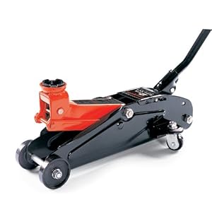

I too have to park my boat on a down hill slope. What I do is use a 3 ton floor jack to raise the tongue high enough to slip a box of criss cross 4x4s that I made under the tongue jack. Works fine for me. And with the tongue weight it would take 4 men and a boy to lift it off to try and steal it.

I carry a shop type jack for possible tire changes on the truck or trailer.
It works well for raising the trailer tongue to insure drainage from the bilges. I have an aluminum one that I found at Costco.
