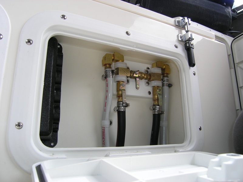

Maybe this is it. If so, it's in Doryman's album.

Rob and Karen thank you! This is the photo I saw!

I've done several fuel selector systems like the one shown in the photo above. And while the installation was done neatly I will point out that the 180-degree turn at the top (2 90's) is very much less than ideal. If at all possible when you do yours try not to get radical turns introduced into the system.
The idea in simple form is to have a shut-off valve in each of the two fuel lines from the tanks and then to have one "cross-over" valve.
Just for further explanation...
Each of the two inline valves (in the lines from the tanks) are essentially selector valves for that particular tank. That is, they're they gatekeepers and they specifically determine whether any fuel leaves their attendant tank.
The cross-over valve is just that, it let's fuel cross-over from one tank to the engine on the opposite side (note that 3 valves are not necessary for a single engine boat).
- If you close both inline valves no fuel flows (regardless of how the crossover valve is positioned).
- If you open both inline valves, and the crossover is closed, each tank feeds one its own engine.
- If you close one inline valve and open the crossover, both engines will be feed by the tank with the open inline valve.
- If you open both inline valves and open the crossover almost all the fuel is supplied by each tank to its own engine...the crossover having very little impact on things.
