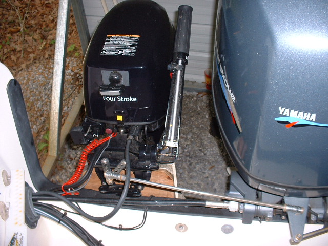

I have a 150 Suz w/ 9.9 kicker on my 25 Cruiser....me likes alot.
Kicker Mounting Bracket: Garelick (Mftr) Model #71091 Heavy Duty Outboard Motor Bracket
http://www.c-brats.com/modules.php?set_albumName=album902&id=CIMG0416resized&op=modload&name=gallery&file=index&include=view_photo.php
I am what I am & that's all that I am & there ain't no more.

Posts: 4673
PostPosted: Thu Jan 20, 2011 10:54 pm    Post subject: Reply with quote
That appears to be a 15" leg. Yes? Question How's that run through the water? Can you attach or do you use a tie-rod between it and the main? I know that model of Garelick has a higher lift range than the 71090 model; I believe it's like 15.5" vs 9.5" (assuming it's mounted parllel to the water). mmmmm....

PostPosted: Thu Jan 20, 2011 11:04 pm    Post subject: Reply with quote
Yes.
71091: H.P. Rating: Over 7 1/2 to 25 Motor Weight Not to Exceed: 175 lbs. Vertical Travel*: 15 1/2" (39cm) Mtg. Pad: Poly Mounting Board Dimensions W x H x T: 11 1/2" x 12" x 2"(29 x 30 x 5cm)
http://www.garelick.com/product.php?pnumber=71091
"In" the water it runs great - no worries. Sits "in" the water.
"Out" of the water - when not "on-plane" but rather "sitting" in the water (e.g. where it spends most of its time - not-in-use), only a very, very small [maybe 2"] dips into the water line - while "on-plane" the kicker is "just barely" out of the water. Obviously, you can mount the bracket wherever you choose (including height above water line). You can see where mine is mounted. I had a boat a long time ago, one of my first center-console-types, while living in FL. The engine went South off Anclote Island. I spent the night hanging around the island, calling Tow Boat USA. I've never been w/o a kicker. I don't use it for trolling, I start it up to make sure it runs each trip. It's my emergency/get-back-home engine.
I don't use it for trolling, so I really have no intention of cross-member to main. If I need it that bad to get back home, I'll sit in the cockpit and steer her back and be glad I got back. Laughing
