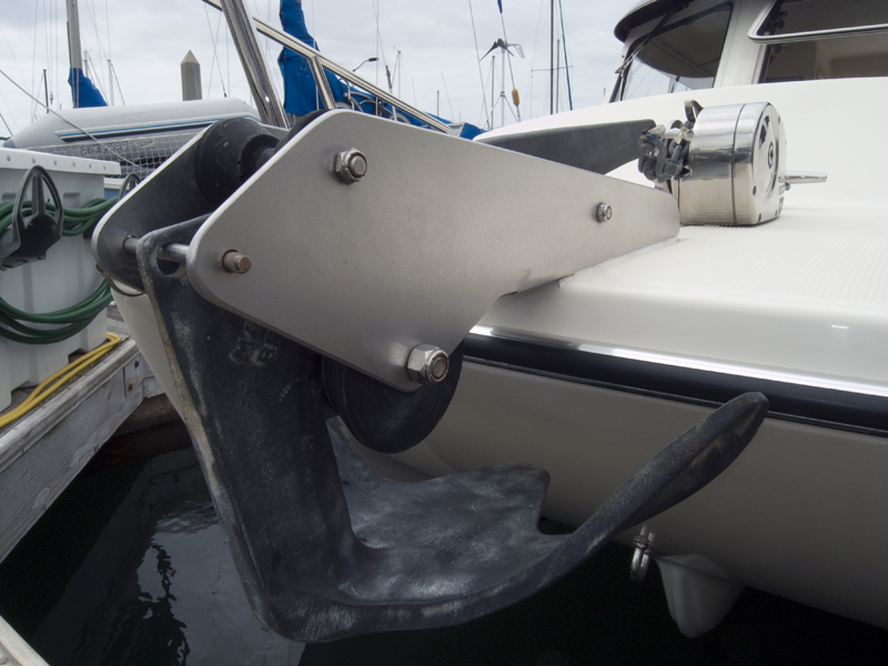

Not sure if this is helpful, but I'm pretty happy with the "Perfect Bungy" solution, which I just wrote about at Navagear.
And yes, that white plastic thing is a patch covering the hole where my windlass used to be. At Friday Harbor, you can me to pontificate at length on the following topic: "It's virtually impossible to avoid misusing a windlass unless you're willing to make MORE trips to the foredeck and back than you would if you were deploying and retrieving by hand!" Smile
