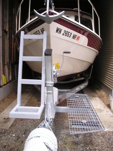

Posts: 21378
PostPosted: Sat Nov 21, 2009 10:02 pm    Post subject: Reply with quote
Our tom cat trailer has a very simple ladder basically "L" brackets welded to the winch post:
The black is self amalgumating tape on the ends of the "L" extrusion.
PostPosted: Sun Nov 22, 2009 12:20 am    Post subject: Reply with quote
Another way to do it is to put the ladder on the boat, that way you can use it both on the trailer and on the beach:
On the trailer.
On the beach.
Stowed for travel.

PostPosted: Sun Nov 22, 2009 12:58 am    Post subject: Reply with quote
I did something similar to Seawolf Joe's setup but replaced the hinge bolts with removable pins so when it wasn't needed I could stow the ladder easier. I also placed it on the port side such that I could flip it in and lay it down on the bow without interfering with anything. Easy install, but you really need a board or a platfom on the trailer tongue to ensure you'll stay completely dry.

PostPosted: Tue May 11, 2010 12:15 am    Post subject: Reply with quote
Just to revive this thread--Joe, I picked up a ladder just like the one you used for your bow ladder on Craig's list for $25 about two months ago. I've been trying to figure out how I was going to mount it on a small boarding/swim platform that a 22 has room for, it was getting more involved all the time with trap doors to cover it so there would be a flat platform when you didn't need a ladder. What a genius idea for its use and staying dry (drier ??) when boarding or getting off from the bow!! This tired old body needs all the help I can give it!
Now I have to keep my eye out for a under platform ladder- now I can keep get on with that project and keep it simple!!
