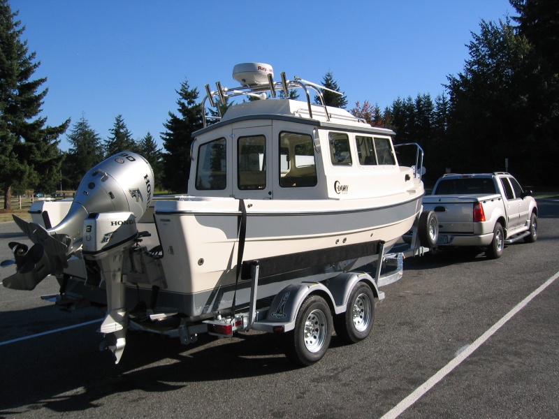

Here's some pictures from my boat (which I don't have anymore). I had the honda 8 classic mounted on the starboard side. Never had a problem with the trim tabs.
Spencer

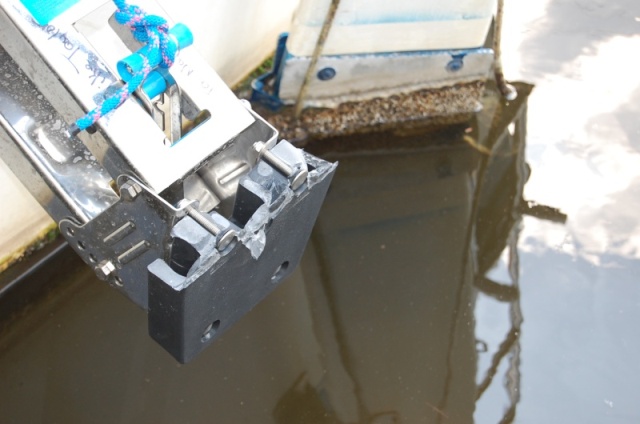

Speaking of Kicker Mounts.....
A picture is worth a thousand words.
Story to follow after I have reached terms with the supplier.
More photos in my photo album.
Sirfice to say...Nassin's don't swim worth a dam.
