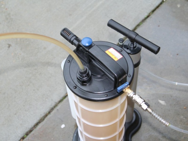

Sucking out the oil, is far easier and cleaner than draining, but it might not be an option for every outboard. Unlike draining, it's also possible with the boat in the water...although most of us probably do our maintenance with the boat on the trailer.
I picked up an Astro 7340 Fluid Extractor (pictured below), which works like a dream. It has a manual pump, but it also has a fitting for an air compressor hose.
With warm oil and the compressor hooked up, it will suck a crankcase dry in a couple minutes, without spilling a drop. I've not used the manual pump yet, but I'm guessing it would be a bit slower. Cleanup is equally easy - pop the top, and pour it into a recycle receptacle.
If using an extraction pump (on any engine), it's probably wise to verify it's getting all the oil the first time used. Simply pull the drain plug afterwards. A few drips is not really of concern, but use your best judgment. I don't see a drop out of any of my engines - the extraction tube easily hits the lowest part of the pan, when inserted through the dipstick tube.

Agree with Da Nag on the vacuum pump for oil changes, especially on Hondas. Don't know about Suzukis but I could never change the Honda oil without making a big mess until I got one of those dipstick extractors. Mine leaves nothing that will drain out thru the oil plug-plus you don't have to replace that washer. Filling the gearcase is another matter. I have never found a clean neat way to do that.

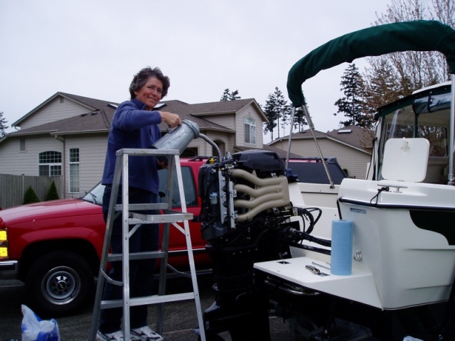

Golly, thanks, folks! I am filled with confidence. And with the knowledge that I can call on one of you if I get stuck.
I think I'm all set up with parts and tools, now. I already had an oil filter, filter wrench, and the oil. John, the parts guru at Jacobsen's Marine in Ballard, helped me find the gearcase lube kit, which has a pump that screws right onto the bottle; probably a little rinky-dink if you're doing this for a living, but looks about right for me. I have two gear-lube gaskets, but NOT the oil plug gaskets, so I'll need to see if that's one of those mysterious items Mac included with the boat...it probably is. I went ahead and got the official Evinrude/Johnson Triple Guard Grease Gun Kit...I don't possess a grease gun of any kind, and the alternative (a squeeze tube with an adapter) looked too rinky-dink, even for me.
Now I'm just waiting for a day without rain. Tomorrow is booked anyway. Kiera and I will be running our RC tug boat at the Pacific Marine Expo.
Thanks again, everyone!
